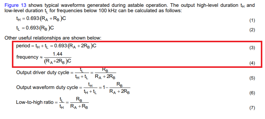

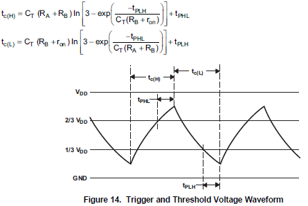

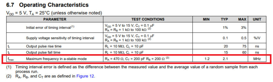

I would like to know the specification about fmax of TLC555 as the following.
When RA=470ohm, RB=200ohm, CT=200pF ware designed like figure12, the result of Calculation in equation (4) in page 16 is 8.2MHz. So I believe that the condition of RA,RB and CT is different.
Would you please correct the specification or condition of fmax?
