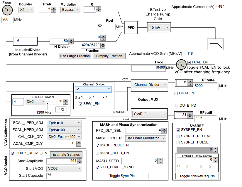

  • Hi There,
    Did you see problem at 5200MHz only or you have problem for any frequency?
    Could you provide a screen shot of TICS Pro having your configuration?

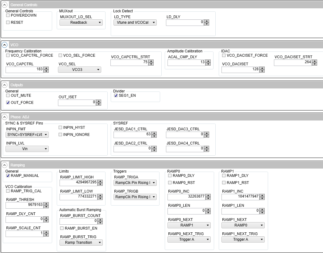

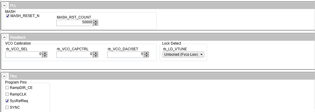

  • Hi there,
    The setting of TICSPro is as shown in the attached image.
    When 1040 MHz is set to be output from RFoutA, stable output of 1040 MHz is obtained compared to 5200 MHz.
    But even then, the 32.5 MHz SYSREF was unstable with a lot of jitter.
  • Hi There,
    The configuration looks fine. One thing you can try is to disable the QUICK_RECAL_EN bit.
  • Thank you for your help.
    It turned out that SYSREFREQ was not stably supplied with High.
    I fixed the SYSREFREQ pin to High on the jumper wire and confirmed that the output is stable.
