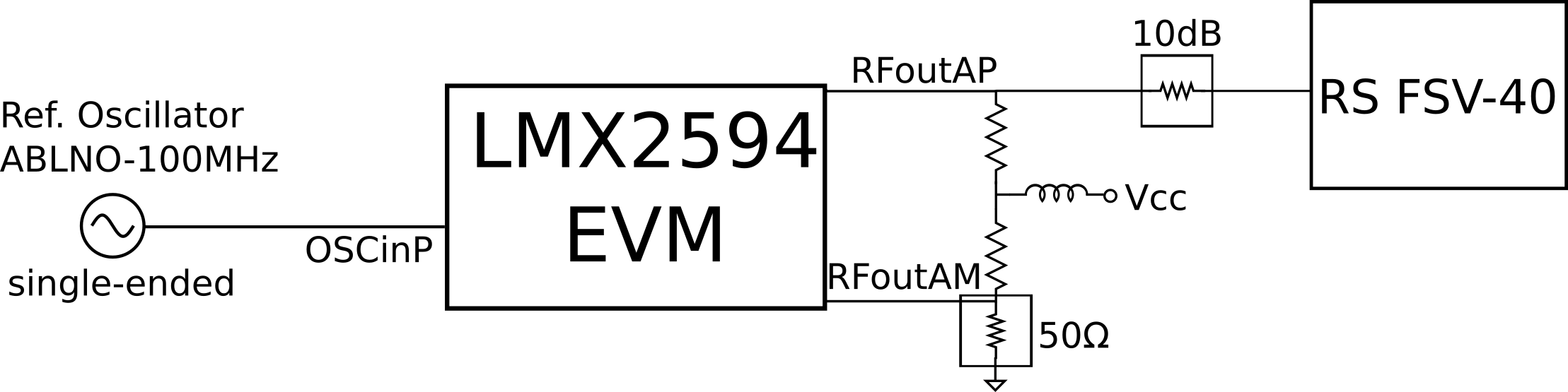

To provide some context,  our measurement setup used is as follows:
We don’t have a phase noise analyser at hand so instead we measure the spectrum of the signal using a spectrum analyser. The close-in (< 100 kHz) noise is dominated by the instrument.

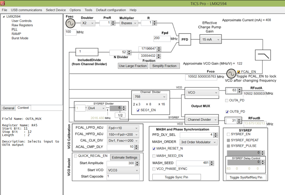

The LMX2594 settings used are shown below and set using the TICS Pro software:

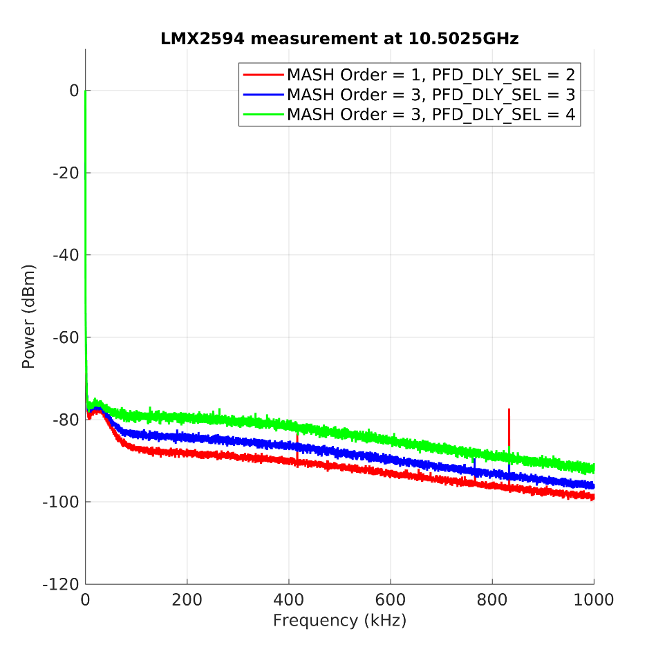

Our frequency range of interest in between 10.5-10.6GHz, and we set our DEN value to 33554432, with the MASH order at 3. For example, according to table 2 of the datasheet we should set PFD_DLY_SEL equal to 4 for an output frequency of 10.5025 GHz, with N = 52 . We are aware that using a large fractional setting for the denominator will result in worse phase noise performance, but we didn’t expect this to be worse when using the recommended setting for PFD_DLY_SEL. We consistently found that using a value of 3 (and the MASH order of 3) that we had a lower noise floor, see the attached measurement. This measurement was made using a spectrum analyser with a resolution bandwidth of 100Hz, hence the power level. We not concerned with the close-in “hump”, we suspect it’s the response of our measurement setup/instrument. The noise floor is about 6-7dB lower using a value of 3, even-though the TICS PRO software gives a warning for this setting.
There is almost no information in the datasheet as to what exactly the PFD_DLY_SEL setting is. Could you provide us with a more verbose description of this? Secondly, can you see any reason why we should not use this setting and stick the the recommended value?

    It is not surprise to me that a different PDF_DLY_SEL will result in better phase noise.
    The values given in the datasheet is suggested by the chip designer, so these are theoretically values.
    In practice, I have seen this theoretically values are not always true, but close. This is not a unique problem to LMX2594, but is a very common issue in synthesizer.
    My suggestion is, try with the datasheet suggested value first, tweak it by +/- 1 setting, see which setting returns the best performance.
