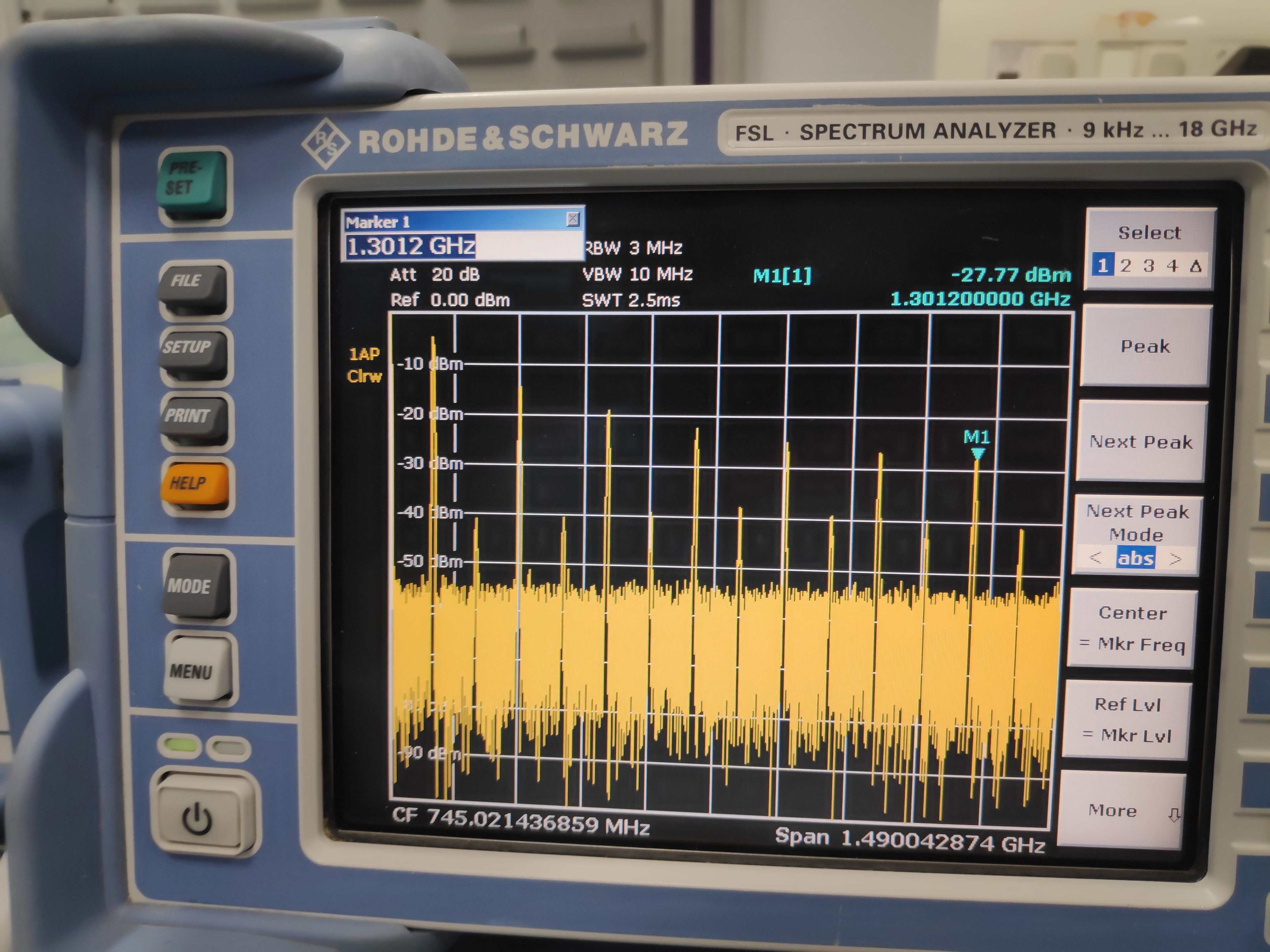

Hello sir,
            I am using LMX2595 EVM, to generate 17GHz signal over 200MHz Bandwidth. I have generated 100 MHz by using reference pro board wherein i am getting harmonics at the output of the reference pro board. I don't know why my PLL is not locking. Even the lock detector is not blinking in EVM. The output of the LMX2595 EVM is also having harmonics at 4.2GHz, 8.5GHz, when I am trying to generate 17GHz. I tried feeding the reference input to the LMX2595 EVM from external source with no harmonics. As far as my knowledge I think it is due to the PLL which is not locking. Please let me know the necessary changes required.

  • Hi Singam,
    Does your EVM come with an on-board 100MHz XO?
  • Yes the EVM has on board 100MHz XO on it. I had tried using the reference signal 100MHz from ref pro board (which has even and odd harmonics) and from the signal generator (clean and stable 100MHz). In both the cases the output is not stable.
