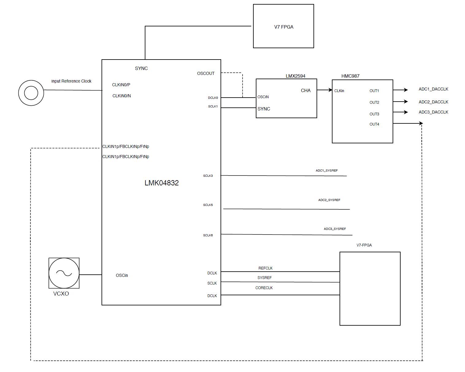

We are using three ADC12DJ3200 in our design.
For ADC's device clock we are using one LMX2594 and ,one HMC987(buffer) to buffer the output of LMX2594 and feed the device clock to three ADCs.
Sysref and FPGA clocks are provided by LMK04832 only.
The clock tree is shown as below:
The dotted lines signals are optional and are not connected default.
In the above image SYNC of LMK04832 is connected to FPGA.
We need to synchronize the all the outputs of LMK04832 and LMX2594/HMC987.
Question 1:
Can we do synchronize/fixed relatioship between LMK outputs when SYNC is controlled by FPGA and there is no relation between input reference clock to LMK04832 and SYNC from FPGA?
I am asking this because, I have read on this forum itself that SYNC should meet setup hold time with respect to input reference clock.
Question 2:
Also we want to align/synchronize the LMX2594 ADCs sampling clocks with SYSREFs clocks from LMK04832. So we have connected LMX2594 sync pin with SDCLKout of LMK04832.
So we are assuming that :
SYNC from FPGA will give a fixed relationship/synchronization between all outputs of LMK04832 and SYNC from LMK04832's SDCLKout to LMX2594 will give a fix relationship/synchronization between LMX2594 output and outputs of LMK04832.
So, if we follow above scheme there will be a fixed relationship between all clocks, which is a requirement for achieving synchronization between all three ADCs and also for deterministic latency.
Is our understanding correct?

  • Hello Lalit,
    1. Applying the synch input asynchronous to the reference will work to have teh outputs phase deterministic.We give some guidelines so no glitches, seen on the output. The timing is random you may have a runt pulse on one or more of the outputs.
    2. Yes, this is correct in that when the LMK04832 output drives the LMX2594 there will be a deterministic phase relationship between the LMK04832 outputs and the LMX2594 outputs once the LMX2594 is synchronized. The propogation delay between the paths will not be equivalent however, so expect some differences in the phase variation of the LMK04832 outputs and the LMX2594 across temperature.
    3. If the SYNC pulse for the LMX2594 is generated from the LMK04832 sysref output in single pulse mode this will allow for aliging the synch pulse input to the OSC input so the timing of the SYNC to OSCin is deterministic.
    4.In the LMK04832 distribution mode, only CLKin1 is active as input. so it is not possible to feedback another frequency domain
    Liam

  • 1, Start an asynchronized SYNC trigger, would generate a non-completed cycle. That's the runt pulse.
    In SYNC, mute all output, no runt pulse.
    Exit SYNC, output normally, no runt pulse
    2, There is no internal path for CLKin0/CLKin1 to OCSout in LMK04832.
