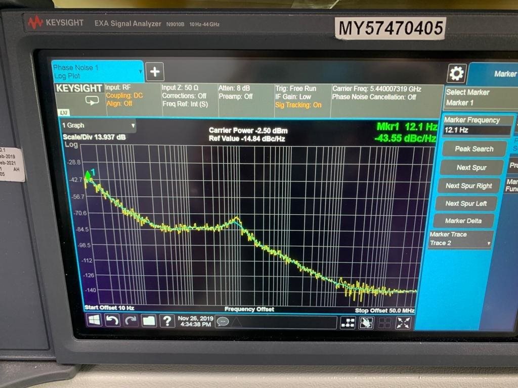

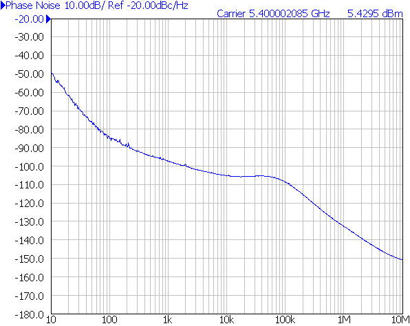

i have a customer that is working with the LMX2592EVM,
As he Is checking phase noise between 10Hz and 1kHz,
He sees a huge rise in phase noise after reaching 300Hz ,
It is not immediate comedown in the phase noise, it keeps rising ,
The reference clk he uses is 40MHz,  and output Is 6-7.5GHz.
Have you heard of problems like this before with this EVM?

    Below 1kHz, the phase noise is basically dominated by the reference clock. Where is the 40MHz clock came from?
    BTW, do you have a screen shot of the measurement?
    Could you also provide the TICS Pro configuration?

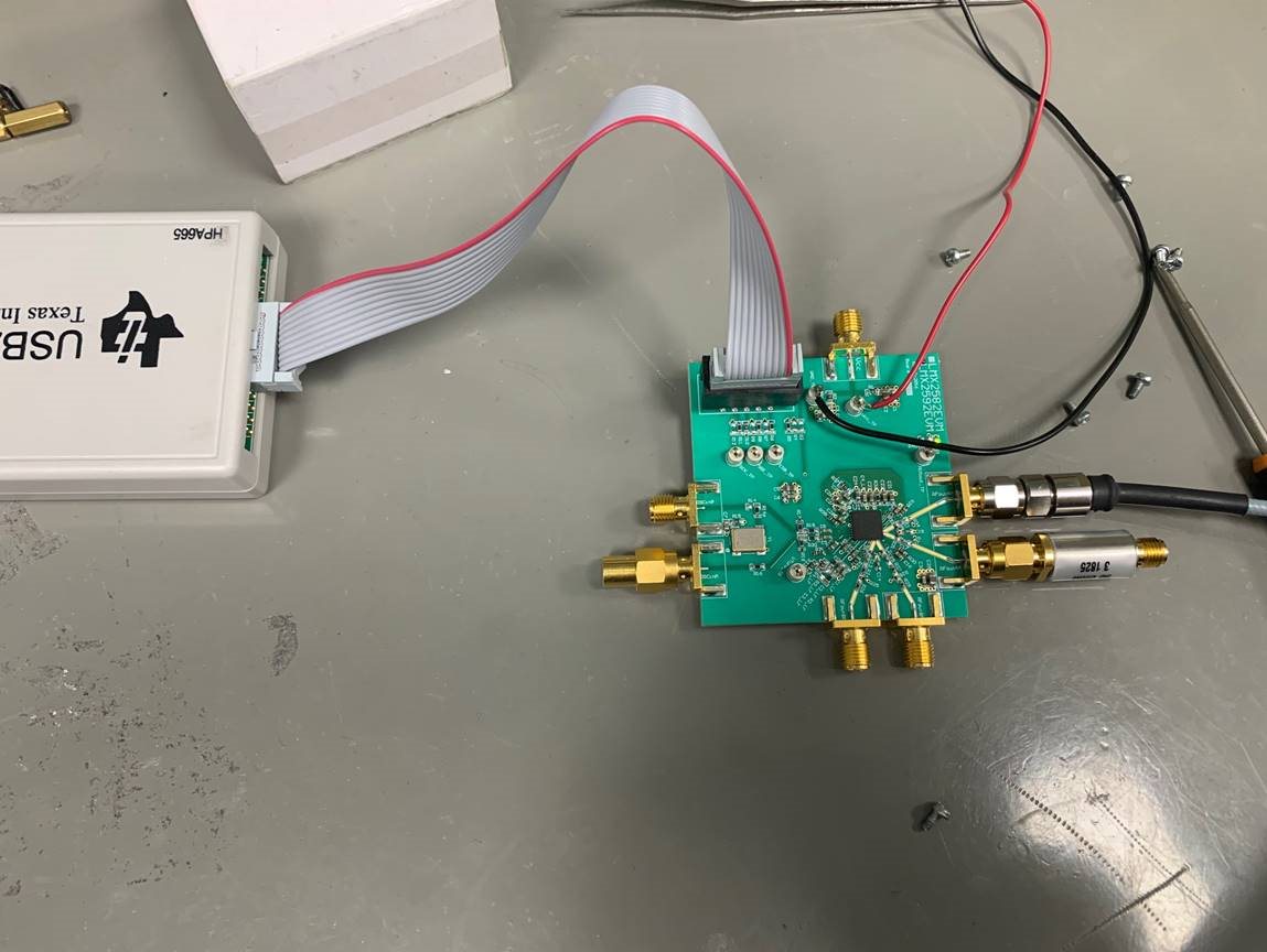

  • Hey Noel,
    As for the 40Mhz clock, it is coming from the EVM.
  • Hi Victor,
    The on-board XO frequency in the EVM is 100MHz.
    This XO is a cheap, low performance XO, its close-in phase noise is known to be bad.
    If you want better <1kHz offset performance, replace this XO with a high performance XO such as Vectron VC-708.
    BTW, their TICS Pro configuration is not optimized. Although OUTB is not used, Output Mux should be set to "VCO". Fpd is too low, integer mode is still ok but the phase noise will be bad in fractional mode. We do not suggest use Charge pump gain greater than 1.5x.

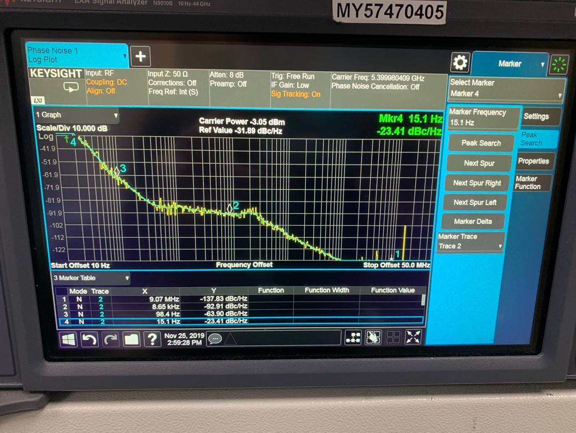

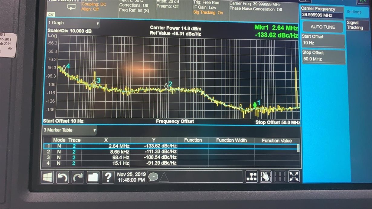

  • This is the phase noise of our TCXO measured on our board (including all distribution systems etc).
    should we sew this on the EVM and check what happens?
  • Hi Victor,
    Your plot is not taken from the TCXO output, it is the PLL/synthesizer output.
    I just checked the system, we never change the original on-board XO, so its frequency is 100 MHz.
    Anyway, to improve <1kHz noise, a good quality reference clock is needed.
    Here is a plot with a pretty good quality reference clock. I used TICS Pro "Default configuration" but changed the Charge Pump Gain box value to "2.5mA".

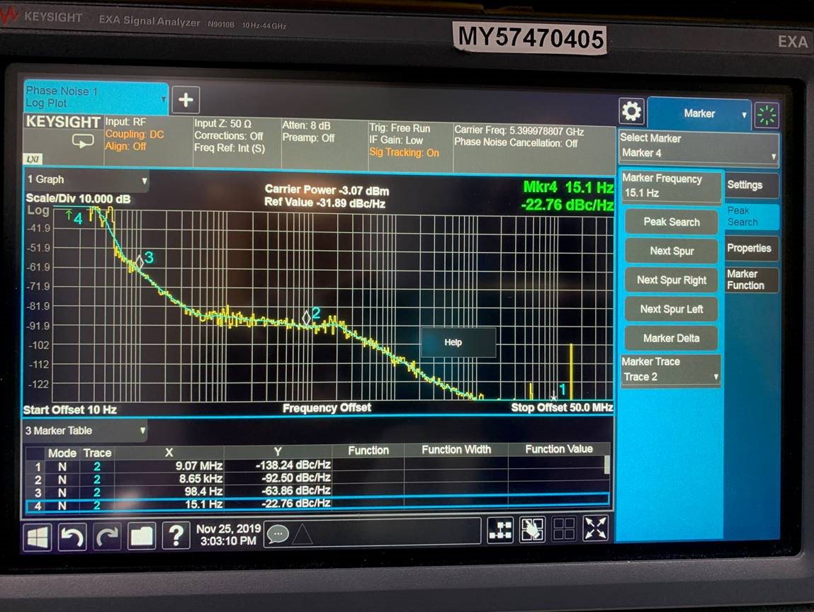

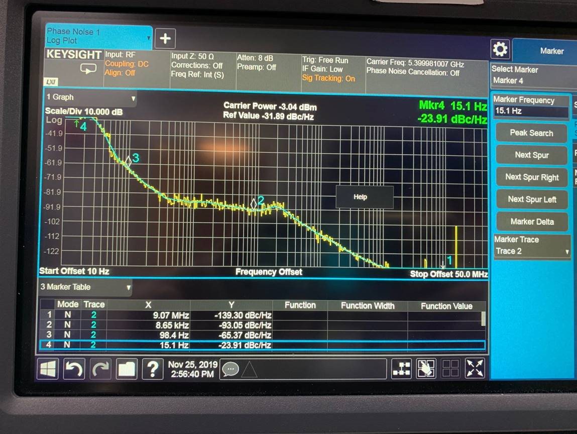

  • This is the result with out TCXO on the EVB.
    The TCXO phase noise spec is
    100Hz               ≤ -117 dBc/Hz
    1kHz                 ≤ -137 dBc/Hz
    10kHz               ≤ -150 dBc/Hz
    If you think there is a better configuration to use I’ll be happy to get instruction.
    We’ve tried the points raised and there was a very minor change.
    The result of the phase noise from LMX using this reference (40MHz) is:
  • Hi Victor,
    I want to emphasize again that the <1kHz noise is determined by the reference clock, we can do nothing, in the PLL, to improve it.
    However, I noticed that their overall measured phase noise at 5.4GHz is worse than my test data. Are they still using 5MHz phase detector frequency? This is not a good idea. Can they try with 100MHz phase detector frequency?
