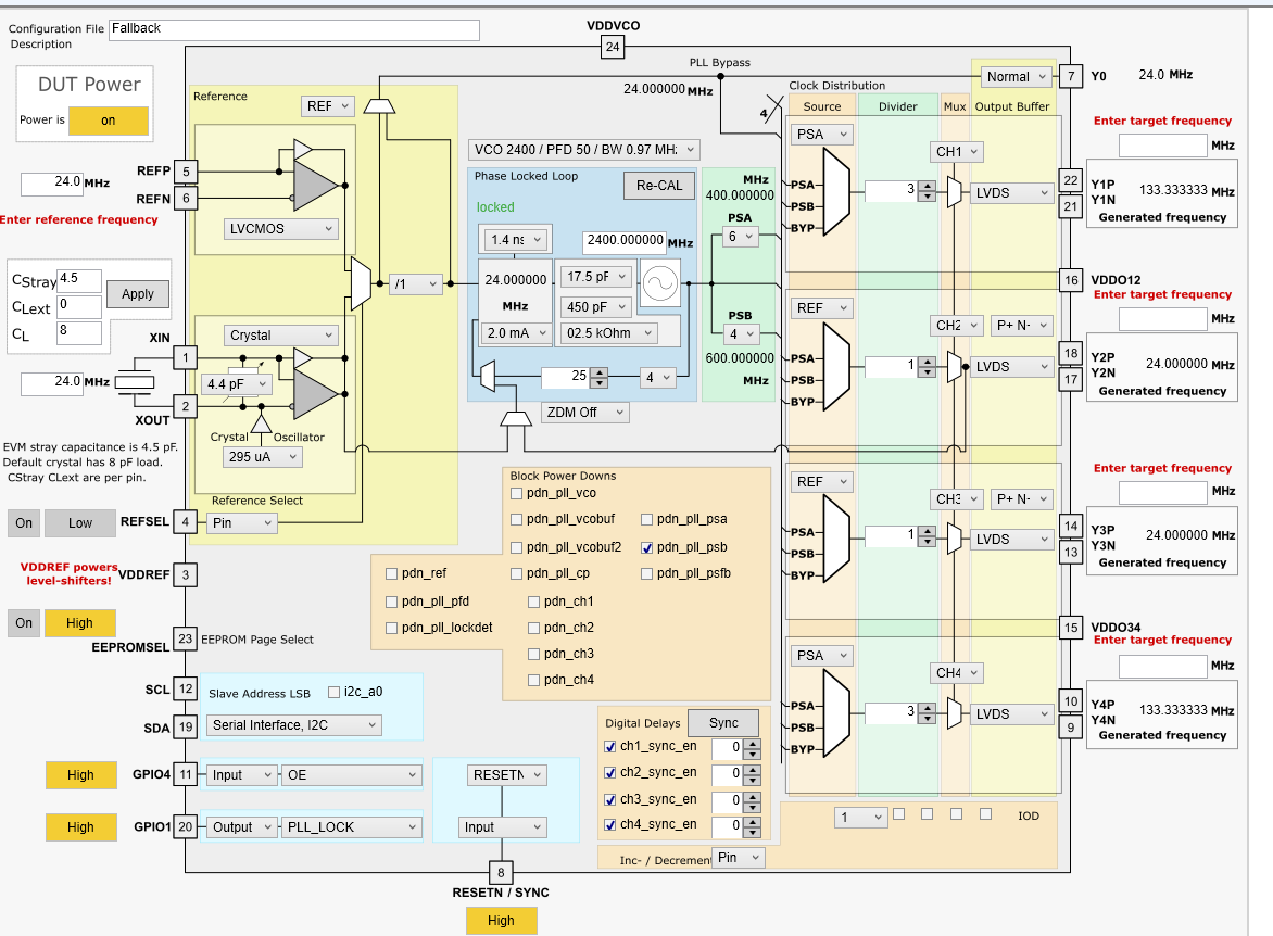

Our products have many different configurations, we should live program CDCI6214.
During production, we found that some devices , the PLL is unlock as shown in the figure below. but other configurations are work .
We checked that the input signal was normal. And then ,We put this chip on the EVM board, and the problem remains.
As  the figure below,
    step1. write all register , PLL is unlock
    step2. Press "Re-Cal" , PLL is also unlock
    Oscilloscope test out that all 24Mhz is out put normal, all 148.5Mhz  is abnormal.
        Our configuration is refer to the datasheet.
        Are there any problems in the following processes??
step1.  ee_lock
step2.   ch[4:1]_1p8vde
step3.   Program register addresses in descending order from 0x44 to 0x00
and we have step4.   "RE-CAL" the PLL

    Total 400 devices , we found that 10% CDCI6214 PLL was unlock. We put these chips on the EVM board, and the problem remains , was unlock.
    Replace the aulty chips .the NG deivce's  PLL was lock..

  • HI,
    the new "TICS Pro"  6214 FOD function was gone ???
  • Yes we de-featured the FOD because we've received and verified reports of failure at certain frequencies, and there wasn't a way around it. The datasheet revision and PCN are in process, if not done yet.
    If you need fractional dividers, please use CDCE6214-Q1 instead. It's pin compatible with CDCI6214.

  • yes,
    only at this configuration
  •      Write a '1' to "swrst" bit at last  , and read all reg, found that  the config rollback to this??
         PLL vco was 2400Mhz...?
