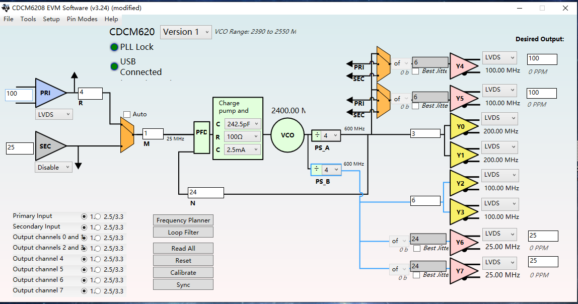

My whole design is like the following picture:
register0~20 reading value is the same with the value I want to write.
But reg21.1 = 1 which means Loss of ireference input. I use an active crystal as the refference input, frequency is 100MHz, 3.3V LVDS and I'm sure that the crystal is ok.
Could you please help me analysis this issue?  Is the configuration right?

  • Hello Jintao,
    Please use attached register settings instead:
    R0	0x000001B9
    R1	0x00010000
    R2	0x00020005
    R3	0x000308F0
    R4	0x000420CD
    R5	0x00050132
    R6	0x00060002
    R7	0x00070022
    R8	0x00080005
    R9	0x00090002
    R10	0x000A0050
    R11	0x000B0000
    R12	0x000C0002
    R13	0x000D0050
    R14	0x000E0000
    R15	0x000F0002
    R16	0x00100170
    R17	0x00110000
    R18	0x00120002
    R19	0x00130170
    R20	0x00140000
    R21	0x00150002
    R40	0x00280102
