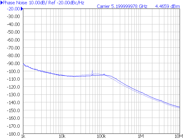

I am using the LMX2572 in a wide temperature range. Starting the operation at room temperature the PLL frequently goes out of lock at temperatures below -35°C (no problems at high temperatures up to the datasheet limits). If I send nothing but a CAL command to register 0 PLL is back in lock again without any problems. To my suprise I observe that the relevant registers R16, R19 and R20 contain the same values before and after the event. Loosing PLL lock therefore seems not to be primarily a CAL issue.
Since lock loss and the following CAL command causes bit errors and sometimes even a frame loss in my data stream it would be good to know the mechanism behind to find some cure. Any idea someone?

  • Hi Holger,
    could you provide your TICS Pro configuration?

  • Hi Holger,
    Your configuration is good, I have no idea why you have problem losing lock at cold temperature.
    R16, R19 and R20 remain unchanged is correct because these are the values you have written to the device.
    Just wanted to clarify:
    1. The temperature you mentioned is the temperature chamber temperature?
    2. You are not toggling it ON/OFF with the CE pin at cold temperature?
  • Hi Noel,
    ad 1. The temperature is measured at the temperature reference point of the unit. The temperature of the chip is perhaps 2 or 3 degrees warmer.
    ad 2. CE is not toggled. I just monitor the lockdetect output and send a CAL command if it goes low.
    If modulation is off and I monitor the clean carrier I notice that the phase noise is increasing at low temperatures, even long before the PLL goes out of lock. In particular the part of the spectrum which is within the loop bandwith rises. The far-off carrier spectrum remains good. I guess this could be a hint that rather the phase detector has a problem than the VCO.
    Holger
  • Hi Holger,
    I tested a board using your configuration, I don't have unlock issue at cold. I first lock the device at 30C and then took the temperature down to -40C.
    Phase noise changed a bit at cold, this is normal and expected.
    In below plot, light blue trace = -40C; dark blue trace = 30C.
