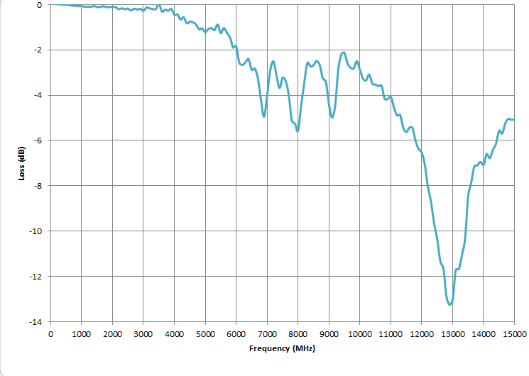

I'm having trouble with this eval board producing low output power at higher frequencies (14-15GHz). I'm aware that the datasheet plots out the output power for either a 50ohm resistor or 1nH pull-up, but since the eval board comes with a different pull-up configuration I wanted to know if 7.5-12.5dBm output power is even possible.
I'm currently seeing output power in the range of (-8.5, -5.5)dBm at these frequencies, which is nowhere near close to what I expected based off the datasheet. I'm designing for single-ended operation so I currently have the RFOUTAM connected to a 50ohm termination. RFOUTAP is connected directly to a spectrum analyzer using a barrel to try and minimize any loss.

  • Drew,
    I measure about -5 dBm disregarding losses at these frequencies.
    With matching, this can be improved about 0.8 dB.
    Board losses are substantial and cannot be ignored.  I calculate about 5 dB a these frequencies.  See chart below.
    So accounting for losses and matching, maybe this could be about 1 dBm for resistive pull-up.
    WIth an inductor and a stub tuner, I got a direct measurement of about 5.5 dBm.  Accounting for losses, maybe 10 dBm.
    See plots for board loss and tuner with inductor.
