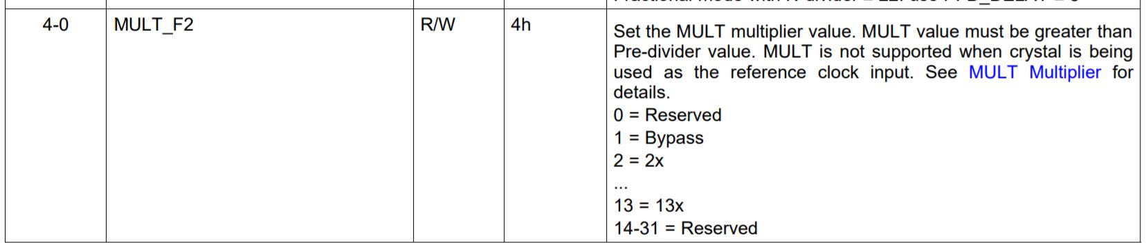

When MULT_F2 value and Pre-divider value is the same(MULT_F2= Pre-divider=4) and ambient temperature is high,LMX2571 internal VCO doesn’t lock.
This is violate following comment but could you let me know the reason why MULT value must be greater than pre-divider value technical point of view?
(MULT value must be greater than pre-divider value)

  • Hi Han,
    I have one more question.
    As I described above, When MULT_F2 value and Pre-divider value is the same(MULT_F2= Pre-divider=4) and ambient temperature is high,LMX2571 internal VCO doesn’t lock.
    Regarding this, When we do following procedure, VCO repeats lock ⇔ unlock alternately.
    1. send register setting for certain frequency with MULT_F2=Pre-divier=4
    2. VCO is locked
    3. heat LMX2571 to 50~60C
    4. change Ninteger/NUM/DEN register setting
    5. re_calibrate
    6. VCO is unlocked
    after 6, when we repeat 4 to 5, VCO repeats lock / unlock alternately.
    could you let me know the reason why LMX2571 repeats this lock/ unlock?

  • Kai,
    TI cannot endorse violating this restriction.
    I characterized the MULT of the LMX2571 over temperature and found that the requirement that PLL_R_PRE<MULT was necessary for reliable locking.
    I tried this on normal, slow, and fast corner lots and saw this issue, especially at higher temperatures.  See the attached plot
    This characterization was a while ago, but design told me that this had something to do with the timing.  You can see below on the first column is PRE_R and the other columns are MULT.  The value is the number of failures.
