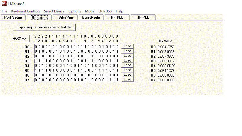

Customer set N counter value with cut & try using Coadloader RF PLL tab.
So, customer just follow the value in the Register tab to have within +/- 1Hz ( ex 421.59000043),but
don't know whether this is okay or not.
(In fact, they had tested those in their board, and test result was fine (C/N=66dB))
I attached customer's  xx.mac file for Coadloader.
Is there anything mistake or anything violation for choosing RF_A ~ RF_C ?

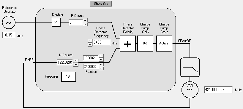

    For example, given N = 81 and P = 16,
    C = 5; A = 1; B = 0
    The frequency resolution is equal to fpd / DEN, where fpd = phase detector freq; DEN = fractional denominator. For example, if fpd = 1MHz and DEN = 1000000, then the freq resolution is 1Hz.
    For example,
    Output frequency will change in exactly 1Hz.

    Q1
    When customer had changed denominator of fraction ( 3450000 in your capture), the result
    is reflected in R1 RF_FD[11:0] ?
    Q2
    If customer hoped frequency resolution in the same fpd ( phase detector frequency),
    customer should increase DEN ( denomination of fraction  3450000 in your capture ) ... is this
    undestanding correct?
    Best  Regards
  • Hi Shibatani-san,
    Correct for both questions.
