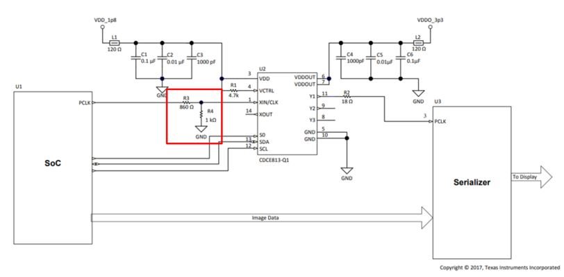

I'd like to confirm this device. In the DS p21 Typical Application, there's a resistor divider to shift voltage level.
Is it allowed to add a divider like a pic below in the case of 65.5MHz PCLK?
The customer's clock is 3.3V which exceeds the recommended spec(1.9V) in DS.

    Yes it is OK to add a resistor divider like this. There is a trade off when choosing resistor values. If the two resistors are too small, then they will draw too much current from VDD when the LVCMOS output is high. If the resistor values are too large, then the input RC time constant might limit LVCMOS slew rate.
    In general, 100 ~ 1000 Ohm should be fine.

    Understood. I'm going to recommend the resistor value @100~1000ohm to the customer.
