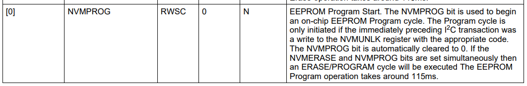

Hi Alan,
In your e2e reply to "LMK61E2: Save ... on LMK61E2 on-chip EEPROM over restarts of the board", the step 4a suggests to
"4a. Write 0x13 to R49 - Set NVMERASE and NVMPROG bits."
Will these NVMERASE and NVMPROG actions have any confliction, if both are triggered simultaneously?
Best Regards!
