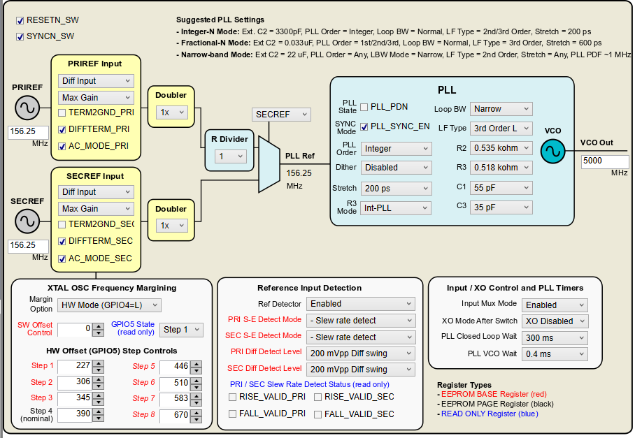

    In case of power up, Customer has applied Single Supply rail according to Figure 83 Recommendation for Power Up from single supply Rail.
    If you need measuremnet data with scope, Please let me know which pins are meansured together with power rails.
    the attached figure is current  configuratin, Just in case, please look into it

  • Hi Mark,
    In order to gain some more insight to the issue, could you please try pulling the PDN low for around 2 ms and seeing if this corrects the output?
    It would also be beneficial to see a plot of VDD and PDN versus time to make sure the ramp is monotonic and that PDN doesn't ramp up too quickly. Do you think it would be possible to provide this?
    Also I can't seem to locate the PDN pin in the schematic you sent. Could you let me know if the pin is floating or has a capacitor on it?

  • HI Adam
    In case of PDN, It is connected to CPLD and external PU resistor. I reckon you consider to take additional care to prevent unsuccessful PLL calibration.
    For this case, Datasheet recommends two ways : Add R-C time constant with 200Kohm resistor and Provide a larger PLL Closed loop delay by R119 register.
    -. they are used to add dealy for PLL Loop to stablize. So before your mail, We added dozens of milliseconds to PDN pin.
    - . With added dealy on PDN pin, The phenomenon of the problem seems to occur less. But it's not a complete solution.

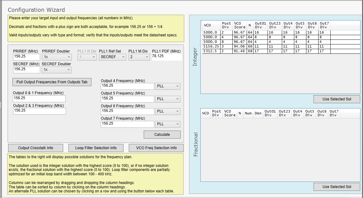

    2. Second problem is related to N-Divider 's value in PLL Block.
    With Wizard tab on TICS pro, We got 5 recommended combinations as below figure and applied them in sequence to find out which one is better.
    As figures, N-Divider column recommended decimal 64 or 66. When applied one of combinations which N-divider was 64, the clock output was not observed.
    In order to get clock output, 66 was right value for N-Divider
    Q) why did only 66 work?

  • Hi Mark,
    The register settings you sent in your initial message don't seem to match what you have in that last post. The configuration you sent has all outputs set to 50MHz as well as a VCO frequency out of the recommended operating range. Do you think you could send the latest register settings so that we may better assist you?
    Adam Siismets
  • Hi Adam
    When I saw first post, I found out I missed PRIREF and SECREF frequency. Due to it, you can have differnet output clock.
    They are 156.25MHz. With register values which I attached file plus input clock frequency, VCO and PFD frequency were set in the recommended range.
    And, in case of test result in lost post, While debugging problem, Customer tried many things. Some of them were to adopt register setting recommended on Wizard tab.
    - with last test, Customer found out that when PLL_NDIV(R58,59) had Decimal 64, the Clock outptu was not generated normally even register values was recommended on TICS.
    - As figure in previous post, one of Calcuated setting on Wizard had PLL_NDIV=66 and when it was adopted, Clock output was generated.
    Current Problem and question are  same with question and problem in previous post.

  • Hi Mark,
    Can you confirm that you waited for the device to stabilize in the error state before pulling PDN low for 2ms? Again, it would be helpful to see a plot of VDD and PDN vs time to make sure the ramp is monotonic and that PDN doesn't ramp up too quickly.
    As for the N divider problem, could you route PLL RDIV/2 and PLL NDIV/2 to the Status0 and Status1 pins and send plots for the N divider at 64 and 66? This will help verify that the PLL is working properly. I will do the same measurements so that we can compare.
    Adam Siismets
