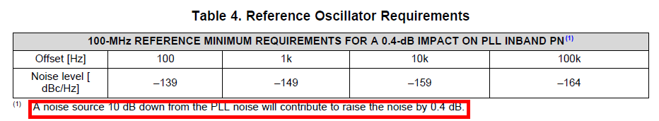

     From lmx2594 EVM instructions page 17,i see that there is a note said that a noise source 10dB down from the pll noise will contribute to raise the noise by 0.4dB, and how this calculate it?

    From the comment of 10 dB down contributing 0.4 dB.
    Noise_PLL = x dB
    Noise_OSC = x-10 dB
    Noise_Total = 10*log(  10^(Noise_PLL/10)+ 10^(Noise_OSC/10)   )
    = NOISE_PLL + 10*log( 1 + 10^(-10/10) ) = NOISE_PLL+0.41
    Dean
