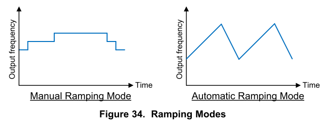

There are descriptions of ramping mode as follows.
What kind of application are these mode used for?
We assume that each mode has fitable application.

Generally the frequency agile systems to make use of this function would be some type of radar applications.
Both manual and automatic ramping achieve the same function, but slower response systems or those that jump between discrete frequencies in non monotonic fashion may prefer manual.
