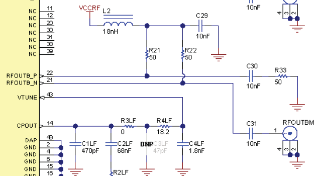

It states in LMX2594 datasheet on p.8 that single ended output power at 15GHz is +2 dBm (using resistor) and +7dBm (using inductor). We are getting -7dBm at 15GHz reading on spectrum analyzer. Cable and connector losses are about 2.5dB.
The frequency of signal is correct, the R44 value is 2C1FA3, this is the highest power I've seen. R45 value is 2DC8DF.
The kit has been modified to drive RFOutA deferentially, we are looking at P side. N side is terminated via 49.9 to the GND (after DC blocking cap).
Please explain what is going on, we are missing at least 7 dB.
