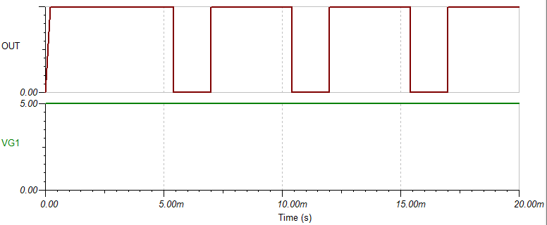

My customer would like to calculate time from power supply turn-on to stable output.
"?" on the attached file is the time.
Can we calculate this?NE555.pdf

    Before power up the timing capacitor is discharged. Therefore at power up the output will go high immediately (within a couple microseconds). The first high output pulse will be 58% longer than the other high pulses after that. The reason is that the capacitor start charging from 0V on the first high  pulse and starts at 1/3*VCC for the rest.
    Like this
    Is the control pin open?
