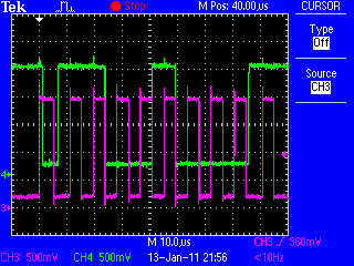

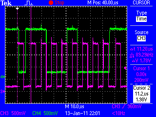

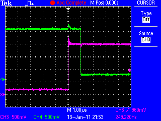

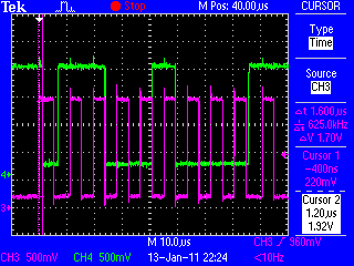

  • As promised, here are the scope traces. Magenta (Ch3) is clock, green (Ch4) is data.
    Setup time during START event
    Entire bus cycle
    Measure frequency of SCK during START event -- about 89.3kHz
    Measure frequency of SCK during data transfer -- 119kHz
    Measure time between rising edge of SCK and falling edge of SDA. 1.6us.
    The start timing looks a bit suspect to me -- there isn't much of a delay between SCK going high and SDA going low (a start being defined as a H->L transition on SDA while SCL is high). I'd have expected the transition to sit roughly in the middle of the 'high' part of the SCL pulse.
    Clock frequency is also a little high (120kHz vs the specified max of 100kHz for Standard Speed mode).

    I tried hooking the CDCE925 up to a Microchip PIC18F2520 last night, and used the PIC's Master/Slave Synchronous Serial Port module to drive the I2C bus. The CDCE' acknowledged the address byte and responded as expected. After taking a long look at the data traces from both the FTDI FT2232 and the PIC, I came to the conclusion that the FTDI chip was violating the hold time requirement for SDA -- that is, SCL was going low after the next bit had been loaded into SDA.
    I also noticed that the FTDI wasn't pulling to ground properly. This was fixed by enabling High Current I/Os using FT_PROG. You need an EEPROM attached to the FTDI chip for this to work.
    To deal with the timing issue on SDA, I added 1nF of capacitance between SDA and GND. The CDCE925 EVM ("Page 24") schematic shows a 220pF capacitor, though in my experience this was insufficient.
