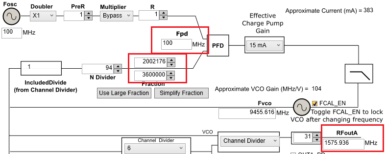

  • Hi Ayush,
    I checked the _1382.4MHz txt file and I see the following issues:
    1. The reference clock is 100MHz, what is the reason for make the fpd = 10MHz? This will make N divider very big and therefore increase PLL noise
    2. Another problem with very low fpd is, in fractional channel, the phase noise at far end will be bad. You may see a bump over there. This bump does not exist in integer channel.
    3. PFD_DLY_SEL is not set properly. Please set it to the suggested value as shown in Table 2 in the datasheet.
    4. This is a fractional channel and there is an expected fractional spurs at 400kHz offset. If your loop bandwidth is less than 100kHz, it is fine, but if you want to have a wide loop bandwidth, this spurs will become obvious. One way to remove this spurs is to set the fractional DEN to 3600001. The output frequency will not be exact (i.e. output freq = 1382.3999979MHz) but I don't think this is matter.
    In conclusion, I suggest: (1) make the fpd wider, say 100MHz. (2) Set PFD_DLY_SEL according to datasheet Table 2. (3) Set DEN=3600001.

  • Hi Ayush,
    1. The problem is due to frequency error and phase noise
    In configuration A, this is your original configuration with fpd=10MHz, the output frequency is off by 18.5Hz. Your DAC will be off by 4 x 18.5 = 74Hz. Second issue with this configuration is the phase noise may be bad because of the phase noise bump I mentioned before.
    in configuration B, the output frequency is exact, there is no freq error and I believe there will be no phase noise bump as well. fpd remains unchanged at 10MHz.
    In configuration C, fpd = 1MHz, as a result, you can get exact 1575.936MHz output.
    If configuration C is already good enough to you, OK, use this configuration. If you want to get better phase noise, you can get exact frequency output with  fpd = 100MHz.
  • Hi Noel,
    Thanks for the clarification. You are right, with 100 MHz PFD frequency I can get a stable output.
