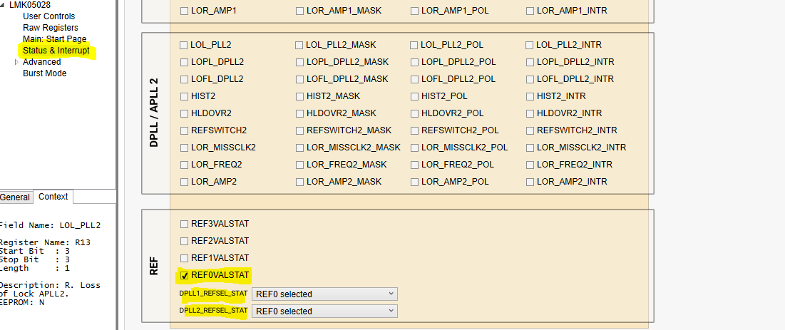

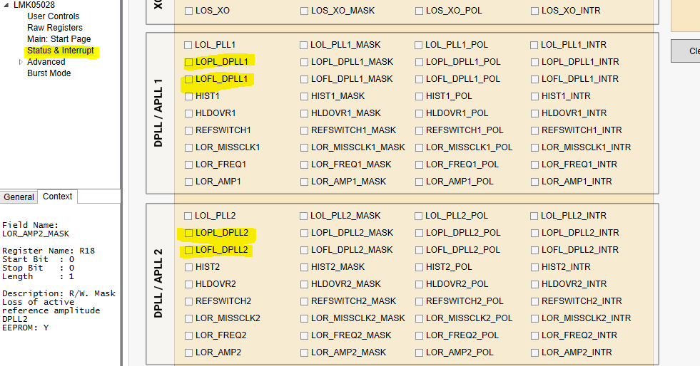

    Status to read back DPLL frequency and phase lock
    Reference Valid readback on status

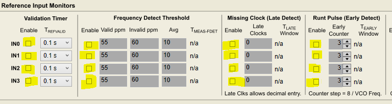

    Disable Validation Timer, PPM detect, and Missing Clock (both missing and runt)

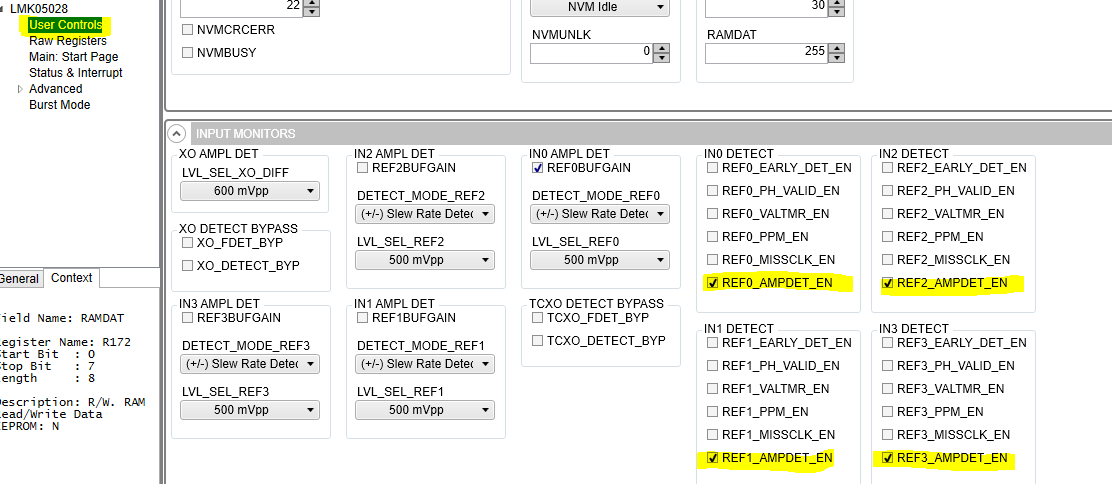

    Confirm only Amplitude detect is enabled for references on User Control tab
    Program Status 0/1 or GPIO 5/6 as R div - N div signals from DPLLx and monitor - in phase or 180 phase shifted to confirm lock - can monitor and observe whether DPLL is trying to lock or it's getting stuck
