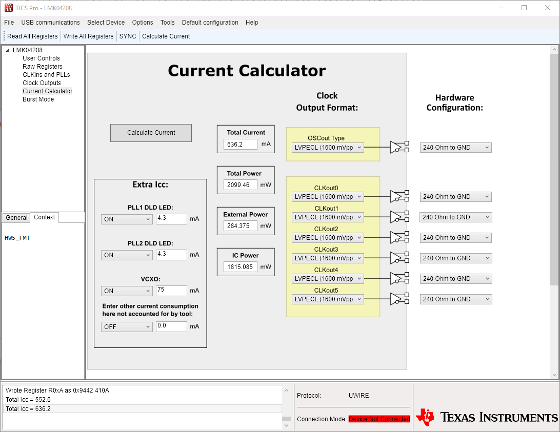

Hello Kuramochi-san,
TICS Pro software tool has a current calculator feature which can be used to estimate the current consumption of the EVM. Using a register configuration that enables PLL1, PLL2, and all outputs LVPECL with 240Ω to GND (including OSCout), I find the worst-case power consumption is around 650mA. However, different use cases will have different current consumption. I encourage you to configure the profile you need in TICS Pro and calculate the current consumption for your use case.
