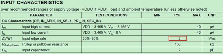

My customer wants to use the CDCLVC1310, and we want to check the slew rate of the device, we can only find the typical value on the datasheet. Do we have the min and max limitation? if yes, what's the risk if not in the range? Whether the 3.85V/ns has risks?
Thanks.
  • There is no min and max limit defined. The input slew rate is specified at 2V/ns typical because the electrical characteristics were characterized with an input with 2V/ns slew rate.
    A faster input slew rate corresponds to a lower phase noise floor while a slower input slew rate corresponds to a higher phase noise floor. For 3.85V/ns, we expect a lower noise floor meaning lower additive jitter.
