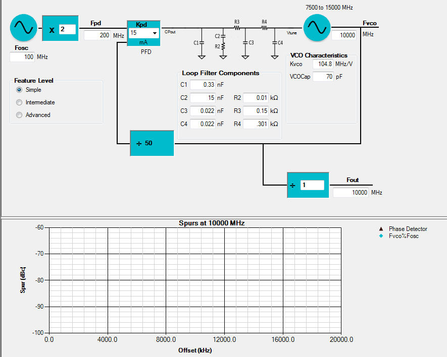

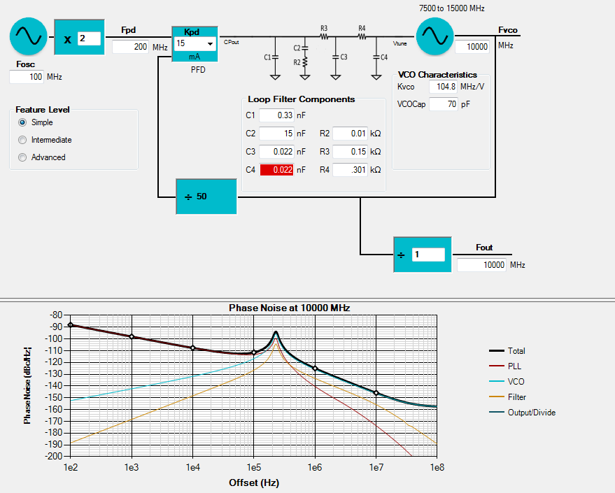

On our custom layout on our board, we are seeing 200 MHz sidebands out of the LMX2594 at approximately 55 dBc. We are using 100 MHz reference and using the internal doubler. Our layout is proprietary. We are wondering if others have seen 100 MHz or 200 MHz sidebands caused or exacerbated by the layout.
