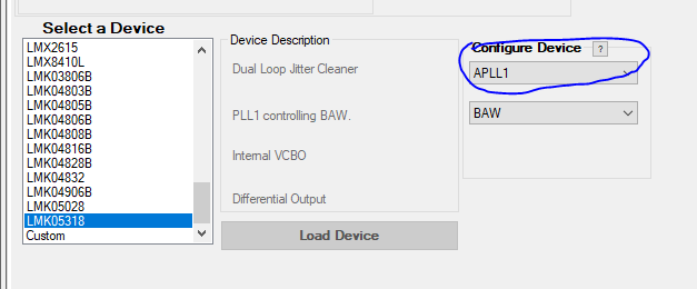

    I am interesting in LMK05318 but i don't know how to simulate the performance. PLLatinum has an option for LMK05318 but it seems APLL. LMK05318 is DLL.
    Could you teach us how to simulate LMK05318 by PLLatinum?

  • Hello Liam-san,
    Please let me ask you about PLLatinum simulation.
    We can get accurate result by PLLatinum in >100Hz range if DPLL BW is very low.
    LMK05318 DLL goes to APLL N divider. APLL VCO range is very small. From this, we need to use APLL2 with cascade mode if we need fractional relationship between reference clock and output clock. Because APLL2 has wider VCO range.
    Is my understanding, APLL2 with cascade mode is needed, correct?
    If correct, I think we need to simulate twice, in case of APLL1 and in case of APLL2.
    Could you share me simulation file which PLLatinum can load?
    I tried it but it seems not work properly. I would like to modify setting from the simulation file.
    Input reference clock frequency is 10MHz, output clock frequency is 200.1MHz for instance.

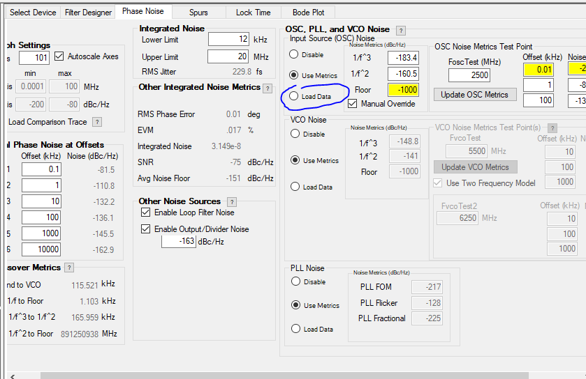

  • Hi Toshihiro-san,
    Yes if the VCO is not 5GHz then PLL2 is needed. For cascaded PLL1 and PLL2 simulation, you need to first select PLL1, design the loop filter and export the phase noise trace (data export -> export trace -> phase noise total). Then switch to APLL2 and import the data for OSCin
    Hao
