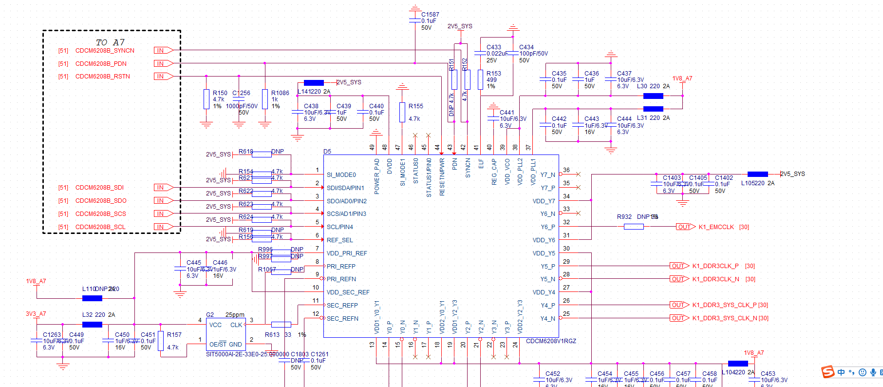

Dear,

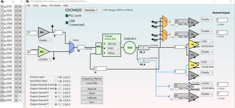

Our customer used CDCM6208V1 and had no output if configured SEC_REF input.
In addition, if the channel 4/5 configured from SEC_REF input, there is output, but if configured from PLL input, there is no output.
The ELF pin is always 0V, it looks like the PLL didn't work. All the registers were wrote properly. The circuit is as following:
