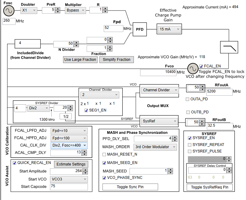

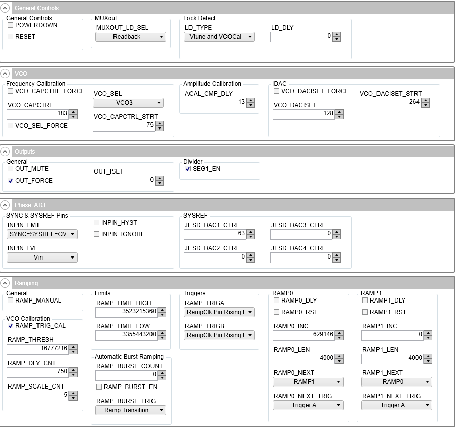

I use LMX mounted on the board which I designed.
When the power is turned on and set first, the clock is output as intended, but when the same setting is written while the power is kept on, the intended output is not obtained.
The configuration procedure follows 7.5.1.
After performing reset and reset release, settings are made from R112 to R0.
R0 is set to FCAL _ EN = 1 after waiting 100 ms or more after writing once with FCAL _ EN = 0.
The final configuration is attached below.
I want to get the same output with the same settings every time, but I don't know how, so please help me.
