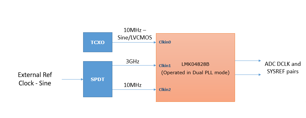

We need to use the LMK04828 IC in below mentioned modes:
- Configuration 1 : Dual Loop PLL mode to generate Device Clock and SYSREF Clocks with a 10MHz Reference Input
- Configuration 2 : Clock distribution mode with the device configured as a JESD clock buffer. The external clock frequency shall be 3GHz.
Need below mentioned Clarifications for Config 2 :
- Can Configuration 2 can be supported by the device?
- If yes, can the 3GHz clock be given to Fin pin (Pin 34)
- Does the Fin pin support 50 Ohm sine input?
- In Clock distribution mode, Can the internal VC0s be turned off to avoid spurious
