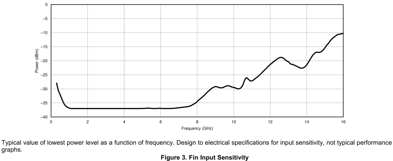

The datasheet only has the min and max value of power for Fin pin, I have three questions:
1. What's the min power for Fin pin when the frequency is 1.6GHz?
2. Is there a power vs frequency graph for LMX2491 which is similar with the LMX2492?
3. What does the "Design to electrical specifications for input sensitivity, not typical performance graphs" mean in figure 3 of LMX2492?

  • Hi Hao,
