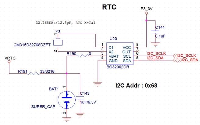

Part Number: BQ32002
Hello
I request a design review for BQ32002.
I attached Schematic image.
The capacity of Super_Cap is 1F.
Best Regards.
Hello
Best Regards.
