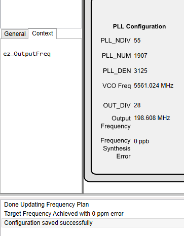

I am developing a system that uses LMK61E2BAA as main oscillator. I am using TI provided Oscillator Programming tool for generation of register maps, however, even while tool reports that target frequency is achieved with 0ppm error, actual output frequency is much higher that desired one. For example, when I attempt to set 196.608MHz output, i measure 198.826MHz in circuit.
I am performing measurements using built in frequency counter function of Keysight MSOX3054T with have specified much lower maximum error. I have compared my measurements to several known-good fixed oscillators to rule out measurement error, but they provided perfectly valid readings.
No matter what frequency i attempt to set on LMK, i always get frequency larger by slightly more than 1%. This is much larger that advertised maximum of +-50ppm total error.
However, when i measure output with factory programmed configuration,the default frequency (156.25MHz) is properly generated with 0.00134% error.
Can anyone suggest what is the reason of such situation?
For reference, i have attached below register map generated by TI tool.
Best regards.

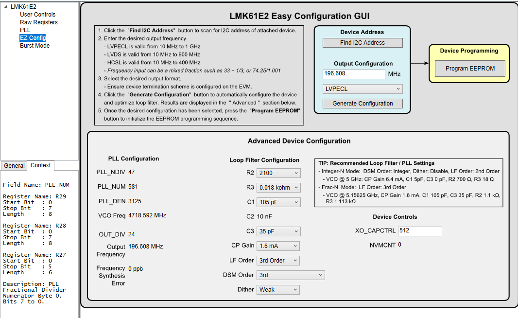

    We have tried this on the bench. Used the LMK61E2 device and the TICspro GUI and produced the correct output. Just typing in 196.608 in the output configuration frequency box and clicking generate configuration produced correct results.
    For 196.608 MHz configuration we measured around 196.6071x. This equates to ~5 ppm error. We programmed eeprom and did multiple power cycles, with no issues.
    I don't know whether original image (in the first post) is still the valid one but as Hao mentioned there are major differences from that and what the GUI generates, for example the VCO frequency. How did your GUI arrive at 5561.024 MHz? It should generate generate the configuration Hao provided.
    Secondly, looking at R72 being 02, I can already confirm a read all registers wasn't performed. R72 goes to 0x02 to recalibrate the VCO but it self clears. We have confirmed this on the bench, after generate configuration and saving raw registers, you will see R72 at 0x02 while performing a read all and then saving registers, you will see R72 has already cleared to 0x00. So my concern is if no read all is perform the registers may not have been updated as presumed.
