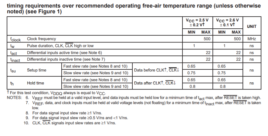

SN74SSTVF16859: input slew rate requirement for SN74SSTVF16859
Part Number: SN74SSTVF16859
HI team,
My customer is using the SN74SSTVF16859 now. We want to check whether the device has the data input slew rate requirement. From the datasheet below. It seems to need slew rate 0.5v/ns.  Want to double check with you. Thanks.
