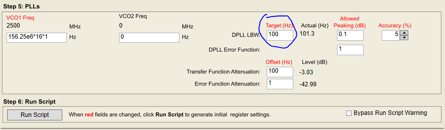

  • Hi Hirotaka-san,
    The PLLatinum sim can simulate the APLL1 and APLL2 separately. The idea is to save the output phase noise of APLL1 and feed that as reference noise to APLL2. The DPLL cannot be simulated in PLLatinum sim as of now, but if the clock to be cleaned is injected into PRIREF or SECREF and the phase noise after DPLL loop bandwidth will be replaced by internal TDC noise and BAW VCO phase noise. So you can refer to figure 8 of datasheet for APLL1 output phase noise. APLL2 phase noise can be simulated in Ticspro.
    DPLL loop bandwidth can be easily set in Ticspro:
    Hao
