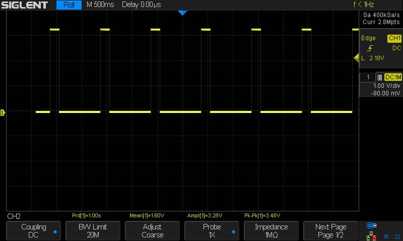

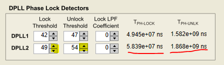

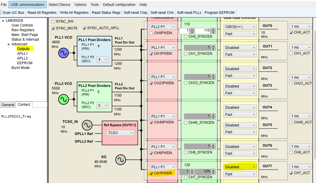

I'm trying to configure LMK05028 to generate a 10MHz output from a 1PPS reference signal coming from a GPS receiver. The configuratio is the following:
XO: 48MHz
TCXO: 10MHz
IN0: 1PPS
OUT0: 10MHz from DPLL2
DPLL2 Mode: 3-loop
I attached the .tcs file in order to let you have a deeper look to my configuration.
On OUT0, I get 10,000,003MHz rather than 10,000,000MHz; after some tests, it seems that the component do not correctly locks to the 1PPS input: infact, the 10,000,003MHz output is present even if the GPS receiver is not connected.
What would you suggest to solve the problem?

  • Hi Amin,
    we are using the 3-loop configuration and probably the PLL is not only locked to XO but also to TCXO (infact, ignoring the TCXO with a 2-loop configuration leads to a much higher frequency error). That's why the output frequency is so close to the expected value. However, we can say now that the reference is not valid or at least not recognized by the LMK05028: a 1PPS signal is connected to IN0 as it is supposed to be, but REF0VALSTAT is NOT checked and DPLL2_REFSEL_STAT show Holdover state.
    At this point, we should focus on the reference signal. These are 2 oscilloscope screenshots which show the 1PPS reference we have on IN0. Could you check if you see something wrong?
    Michele
  • Hi Michele,
    Yes, you probably have 2 loops locked, but TCXO is used for TCXO DPLL. So the APLL can get locked just using XO reference.
    Why is the duty cycle so bad? It looks like the P-duty cycle is only around 20%.
    Amin
  • HI Amin,
    he have made a step forward in this issue. The duty cycle was around 20% because this is the standard GPS setting for the 1PPS output. After trying different configurations (even with the square ware generator), we realized that a 20% duty cycle is not suitable as a reference input and thus we reconfigured it to 50%, both in GPS and the generator. With this setting, LMK05028 now detect a valid 1PPS reference and DPLL2 looks locked to IN0 REF. Unfortunately, the output frequency looks much unstable, going back and forth from 9.9979MHz to 10.023MHz approximately. If we remove the reference, the system goes to holdover mode and the frequency corrections are stopped to the last value.
    Could you suggest some other setting to change in order to correct this situation? At the moment, DPLL2 is set ZDM mode on OUT0.
    Michele

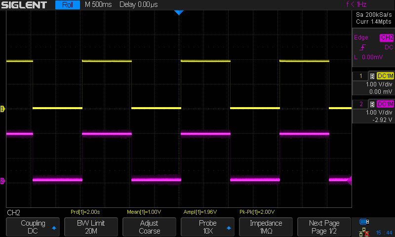

  • Hi Amin,
    actually we are using not just the oscilloscope but also a frequency counter and we can even synchronize the 1PPS input with the frequency output.
    We brought the NDIV and RDIV on status channels as you suggested and this is the result:
    Indeed, if possible, please provide us a .tcs file with a fully tested configuration to generate an output of whatever frequency from a 1PPS reference. We would like to test it and check if the results are similar.
    Michele
  • Hi Michele,
    Apologies for the long delay..
    The ndiv / rdiv signals look good, I assume they're stable and not even moving.
    So when DPLL is locked, you see unstable output with frequency moving between 9.9979MHz to 10.023MHz? and this is done with frequency counter that's synced to the reference input, correct?
    This seems to suggest DPLL is still trying to lock... what are the status signals again? Does is show the ref in that's applied as valid, dpll selects that reference and dpll is frequency and phase locked?
    Also another note on 1 pps, it does take 2 - 3 minutes the DPLL to lock so please make sure you wait long enough.
    Does disabling zdm mode, make any change?
    Lastly I've attached a 1 pps configuration that's been tested perhaps we can look at this one to rule out any system setups.
    Thanks and regards, Amin

    I've made some changes to the .tcs file and tested in lab yesterday. This should have far more reliable times with regards to DPLL lock.
    The reference validation is the validation timer. the detectors have to pass for that amount of time for the reference to be considered valid (only the 1-pps jitter threshold). In this case the reference validation timer was 0.8s so pretty much by 1s mark you will see ref valid flag and DPLL no longer showing holdover.
    However DPLL lock time for a 1pps input can be considerably slower. With the updates I've made I was seeing about ~1-2 min for frequency lock, and ~3-4 min for phase lock, so these should perfectly fall within the 10 min requirement.
    Please test this file and let me know your findings.
    Thanks and regards,
    Amin
    test_0506_updated.tcs

    However to adapt the FW chip to our hardware and to save power, we have made the following changes:
    • Disabled output 7
    • Disabled input 1
    With the aforementioned changes, the flags LOPL2 and LOFL remain set, so the board is not locking.
    Can you please check this configuration on your evm ?
    Michele
  • Hi Michele,
    Did you do a runscript in order to make those changes and that's when things didn't work?
    To disable output 7, all that needs to happen is to change output 7 type to "disabled" and power down the channel. I would also suggest powering down APLL1, that's going to be the big power saver.
    With regards to input 1, there's no enable/disable. So having runscript with it on, just programs the registers, but if no clock is connected then the internal buffer isn't on and there shouldn't be really any current/power associated with it.
    Here's updated .tcs in line with steps above: test_0506_updated2_PDN-PLL1nCH7.tcs
    Please note that LOPL and LOFL for DPLL1 will be flagged now, as they're not being used with the PLL1 powerdown.
    Thanks and regards,
    Amin
    Out 7 PDN and disable

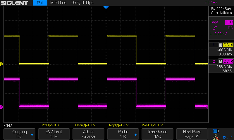

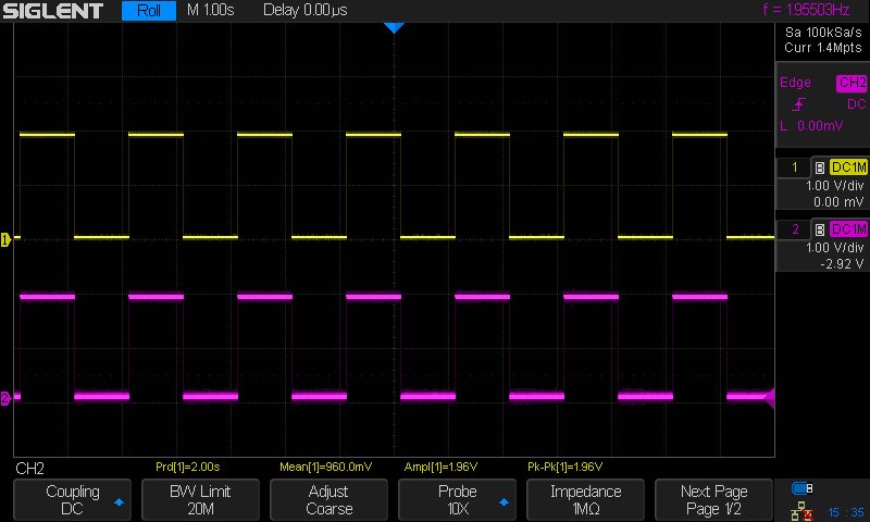

  • Hello Amin,
    Yes we ran the runscript.
    The situation we have with your updated .tcs file on our EVM is the same as we have with our changes.
    The system appears to be very unstable and flags LOPL2 and LOFL2 are not cleared.
    A strange thing that happens when we make changes disabling PPL1 and out 7, is that if we try to go back to the previous scenario and do a runscript, the system is not restored to the previous working state and LOPL and LOFL flags continue to be set.
    Another problem (in our hardware) is that the system is not trying to adjust the output frequency.
    We downloaded on our hardware the same working configuration on our evm (the one with output 7 and PLL1), using EVM’s I2C lines.
    When it turns on, first it is on holdover then when it gets the PPS, it pulls up to a higher range (something like 10.021.xxx Hz) and hangs there without adjusting it.
    I also tried to connect EVM’s system clocks (Xo and TCXO) with our HW without success.
    Do you have any idea what could it be ?

     > Powering down APLL1, and disabling output 7, and loading that .tcs (no runscript ran at any point) DPLL2 cannot lock, is that correct? This is the part that doesn't make any sense as we shouldn't be impacting anything on DPLL2..
    We tried to load the last .tcs file you sent us, that one with APLL1 and out 7, no runscript .
    The system can’t lock, LOPL and LOFL are set, sometimes LOFL is cleared, but during our tests we have never seen LOPL cleared.
    >What happens if you go through GUI and update rather than load the .tcs file I provided. So start with working config (APLL1 and CH7) active. And step by step go through power down CH7, disable CH7 and finally Powerdown PLL1. At which step, does OUT0 coming >from DPLL2 lose frequency and/or status of DPLL2 show holdover.
    We are running the tests you have suggested
    >With regards to the working configuration not working on your board. I'm assuming at no point the reference DPLL locked, correct?
    That’s correct.
    > Was it reading the reference as valid and DPLL just not locking, or was reference never valid?
    PPS reference was valid
    > Next was the frequency error, the 10.0021xx MHz any different when you were using your TCXO vs connecting the TCXO from our EVM? Also, if you can perform a register dump and send that file, I can look at it.
    No difference. Attached the register dump.
    Michele
  • Hi Michele,
    Thanks for the details. How did the testing go in manually updating the .tcs after starting with the APLL1/DPLL1, APLL2/DPLL2, CH7 active configuration.
    Your note above also said: "The system can’t lock, LOPL and LOFL are set, sometimes LOFL is cleared, but during our tests we have never seen LOPL cleared." I'm assuming this implies LOPL2 and LOFL2. As once we disable APLL1, LOFL1 and LOPL1 will be set since DPLL1 is now powered down essetially.
    On your board, what's being used into the reference input for the reference DPLL is the exact same as what was used on the EVM that was able to get the REF DPLL locked?
    I'm requesting lab time for this week to see if I can review the config with just CH0 and DPLL2 active and get expected results on EVM.
  • Hello Amin,
    following your suggestions to disable one by one the unused output and the APLL1 we finally have a working configuration on the EVM.
    The sequence that worked for us was disabling APLL1 first and after that CH7.
    We have performed a large number of tests and the system appears to be reliable.

    Can you probe the IN0 input on the evm vs on your board and see if there are any issues with signal integrity? Any noise on the 1 pps input can be problematic, and unfortunately there are cases where it clears the "reference valid" but REF DPLL still cannot lock.
    A differential signal on IN0 will also work better, as it will have better noise immunity.  You can change the "interface type" in step 2 accordingly, note a run script is not needed.
    Another suggestion, noise from SPI can cause problems. I know you're using I2C, but if we can disconnect those lines, that can be another thing to try.

  • Hi Michele,
    One more thing that I forgot to mention, please increase the phase detect threshold. Increase the lock and unlock until it's at a minimum same order of magnitude as below.
    Thanks and regards,
    Amin
