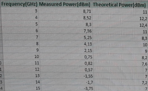

I can not get the output power values as datasheet states.
I always get output power less than expected.

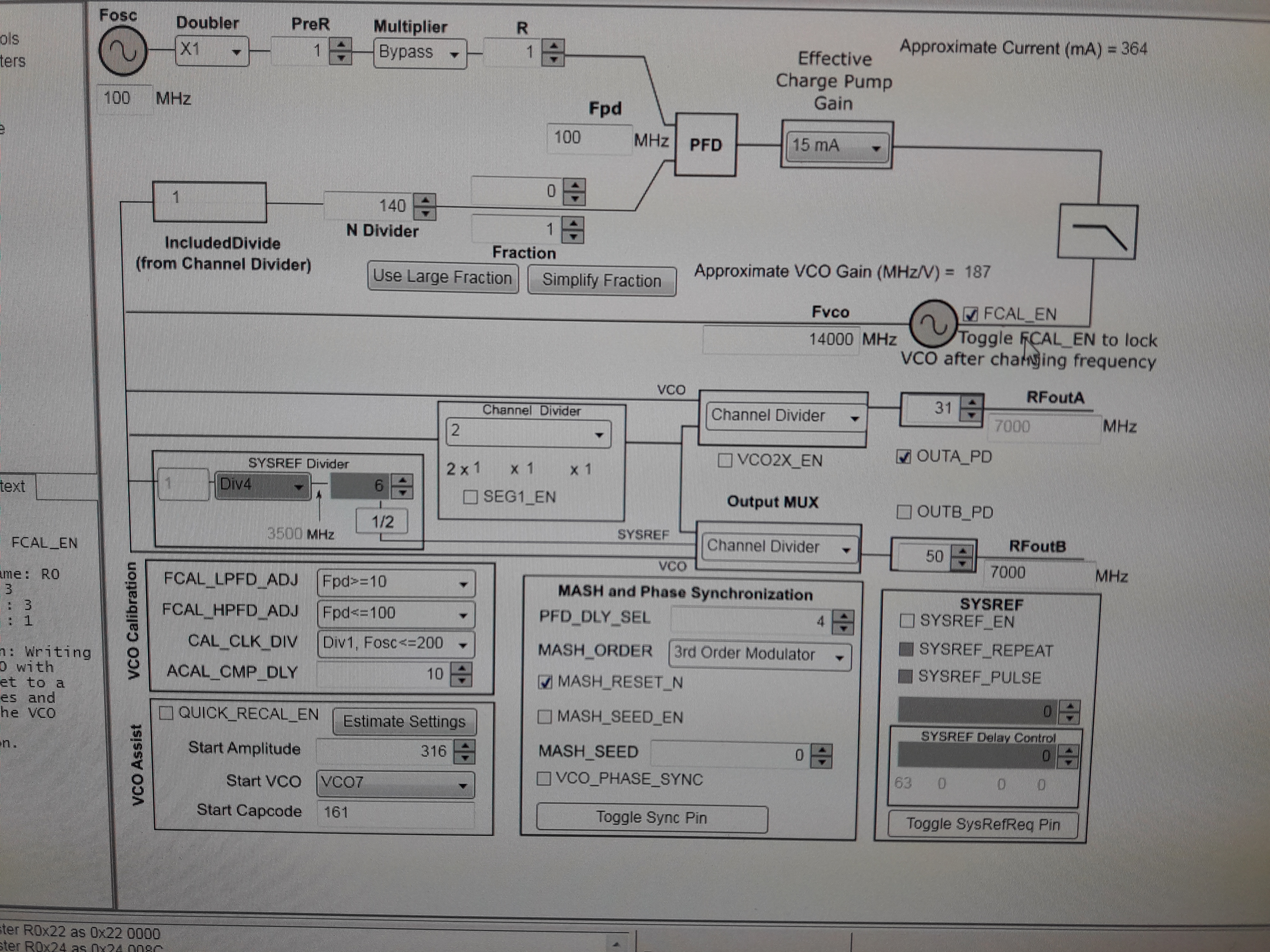

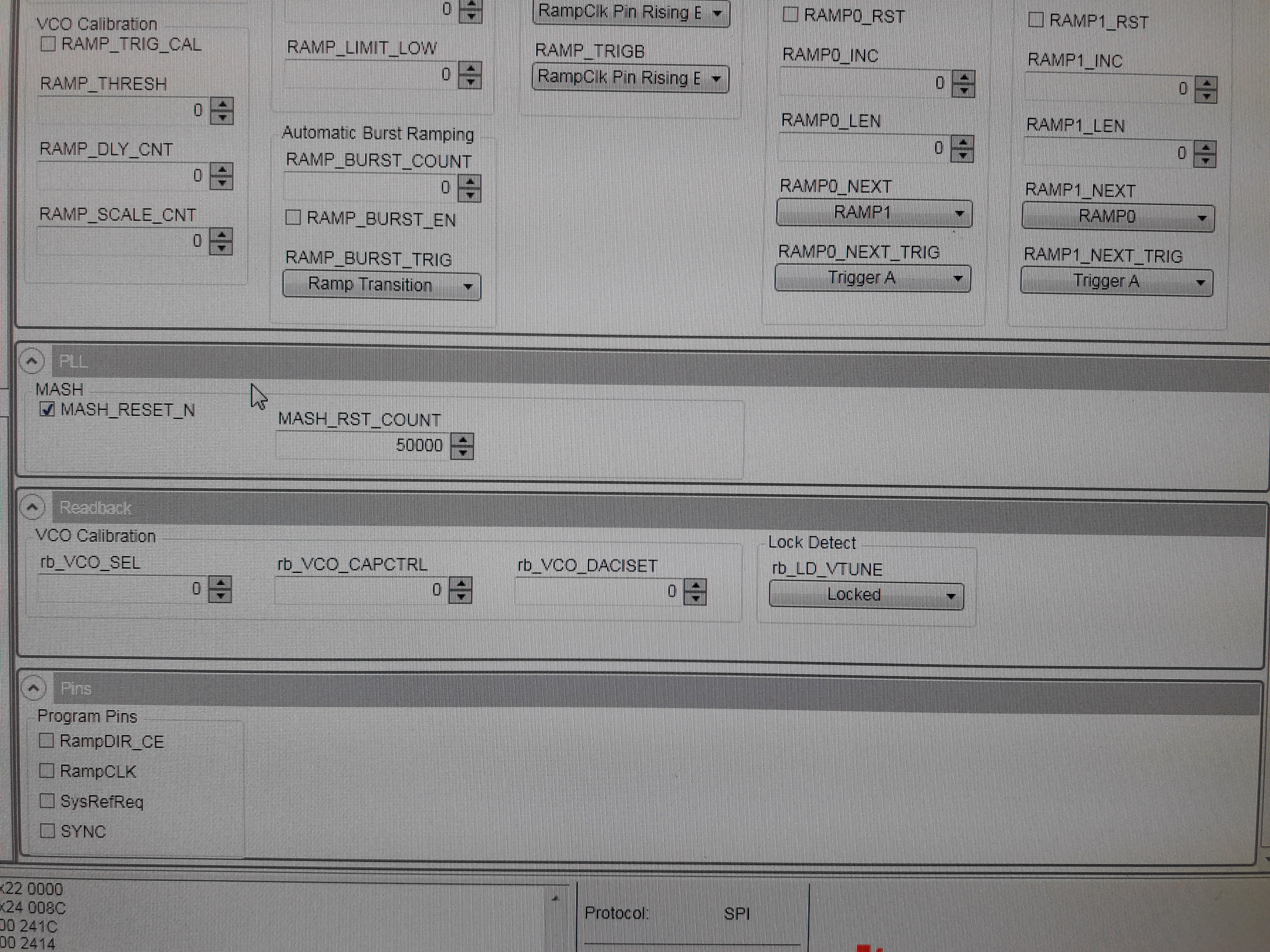

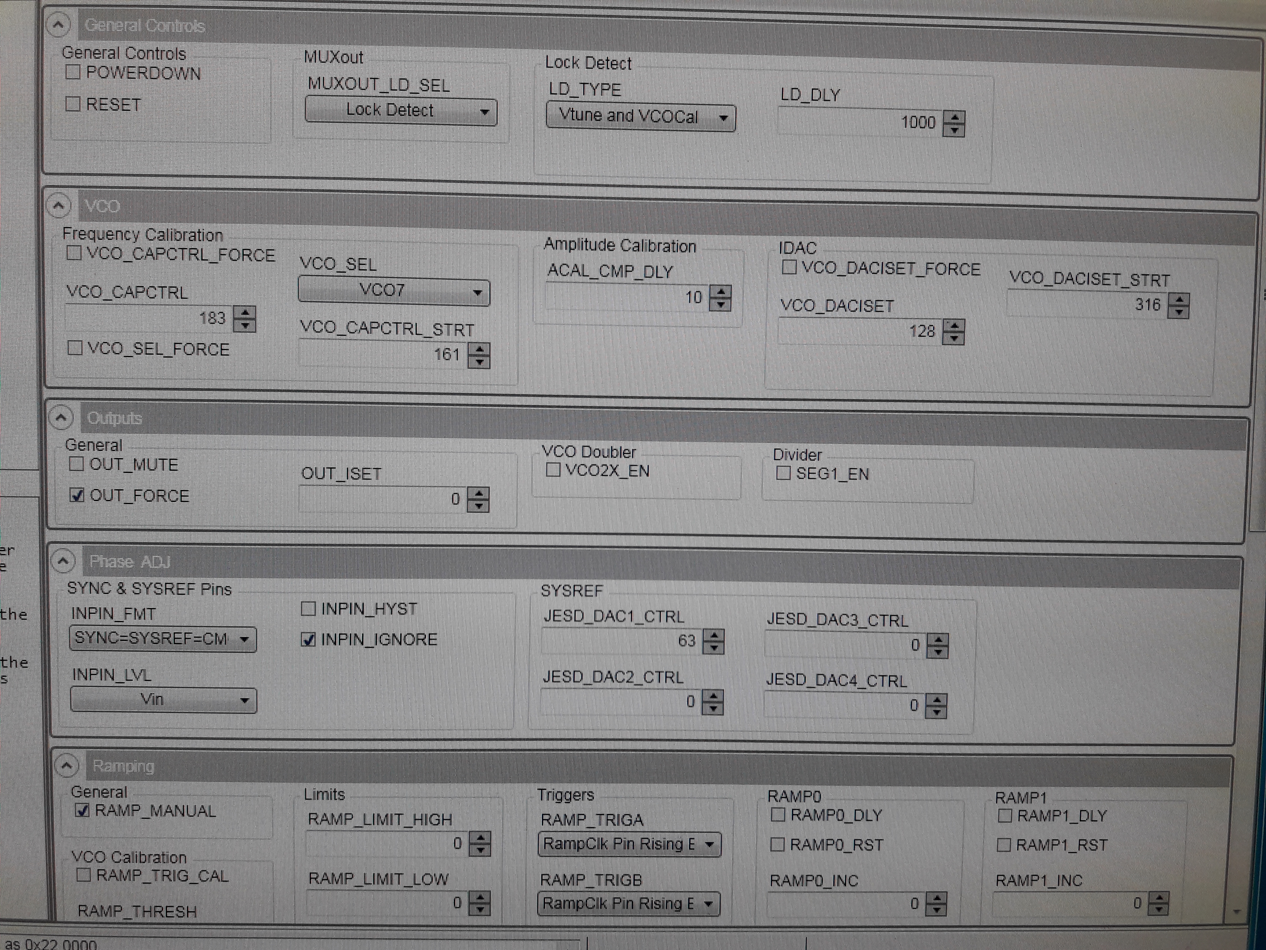

I use TICS software to program LMX2595 Evaluation board.
I think there is something wrong with my settings.
As an example, I attached the TICS software screenshots for 7GHz output.
The datasheet says I should get around 9dBm for inductive pull-up. However I get around 5dBm at 7GHz. I tried other frequencies but output power is always less than expected.
Can you please check the attachments and tell me if there is something wrong ?
