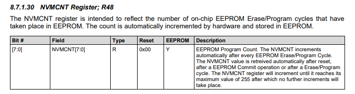

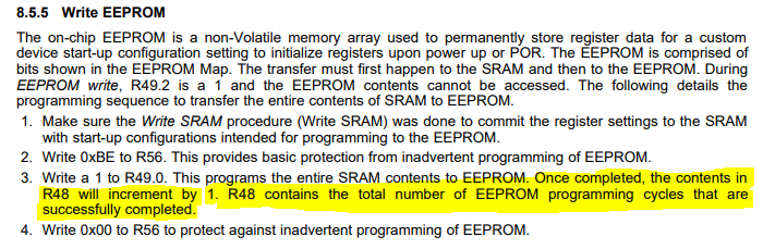

Hi Team,
I know there is sec 8.5.5 which is writing EEPROM step by step procedure. But I would like know if LMK61E2 have a function that MCU know the LMK61E2 had been burned.
The reason I ask that because I would like to use MCU to write the code to EEPROM when 1st power on the system, but in the 2nd or 3rd time, when the system power up, MCU know that LMK61E2 has been burned and don't re-burn the code to EEPROM.
