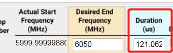

My customer use LMX2491 and use GUI "TICS pro" for evaluation.
But we saw duration value are chaging in the GUI, like below pic. Do you think if it is nornal? And what cause this gap?

Hello Eggsy,
The number changes when the duration is set higher than the maximum value allowed for the particular frequency settings.
The duration it changes to is the maximum allowed duration.
Vibhu
Hi Vibhu,
Customer set the duration is 120us. But chip really runing time is not equal to 120us, which is changing.
The reasonis that you said "duration is set higher than the maximum value allowed for the particular frequency settings".
So how to set duration? And what is particular frequency settings?
Thanks!
Hello Eggsy,
I meant that when you change your fpd, the value at which the software will auto-correct the duration entered will also change.
Vibhu
