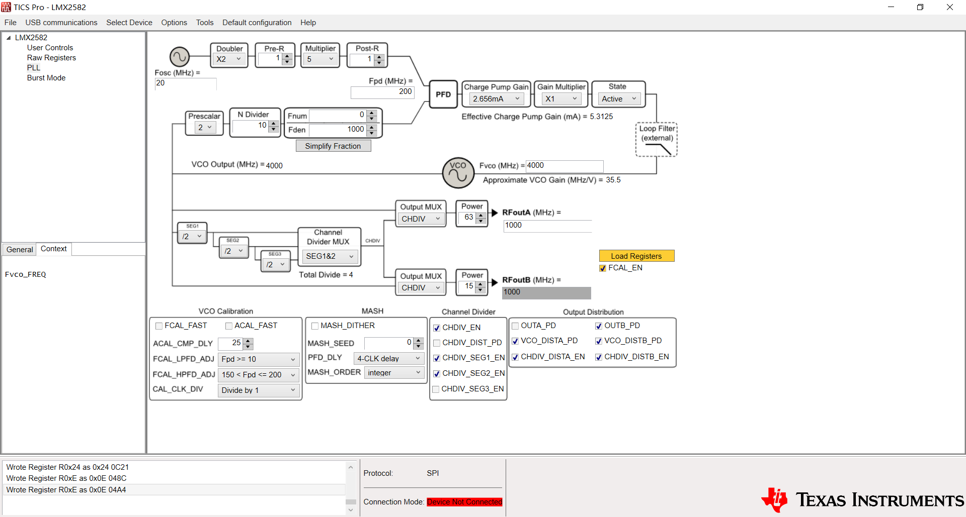

      what have I ignored? Cause I note that the input of the multiplier is 40MHz,which is almost the lower end, when 20MHz was used as fosc.
I have double checked the TISC Pro's  register configurations, there is no error report or warnings in highlight yellow or red.

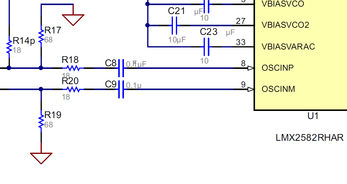

ps:   I layout my demo refer to the LMX2582 EVM (pretty close).

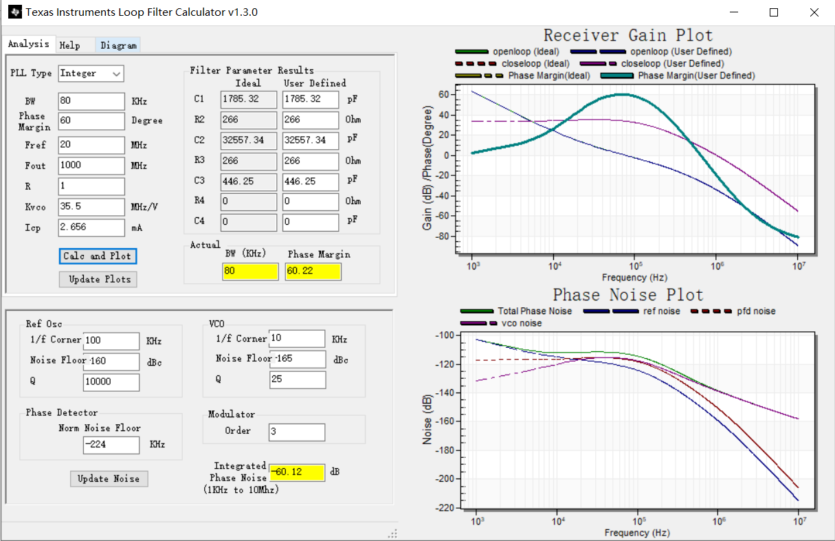

         I upload the screen shot of the TICS PRO.  & the Loop Filter Calculator.
    I have to replace the capacitor C1 with 1nF,  C2 with 33pF,  C3 with 470pF in practice, & R2/R3 with 270Ohm.  Cause I couldn't find the devices with the thoretical values.

    the voltage between R18 & C8 is about 1.5Vpp(0~1.5V or -750mV~750mV) , voltage on the pin OSCINP was shift to the Vcc/2.
    I also replaced the R14/R17/R18  with 33Ohm/51Ohm/33Ohm for the same reason as mentioned above.

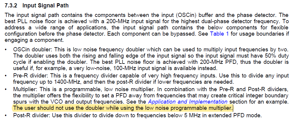

    Please try again without the multiplier in the reference path. Either use x2 or Multiplier, cannot use both at a time.
    In datasheet, section 7.3.2:
    "The user should not use the doubler while using the low noise programmable multiplier."
    BTW, please use PLL Sim to perform a more accurate simulation.
  • HI,Noel
         I  have reviewed the datasheet for the details. It did give a description of the OSCX2 & Multiplier. They can't be used at the same time.
    It seems that 40MHz is the lower limited value for the  LMX2582, I'll try to use the 40MHz as fosc later.
