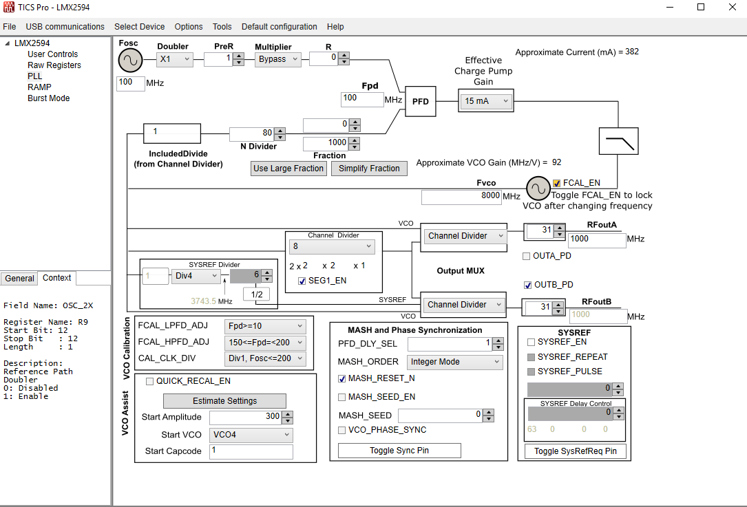

This is Nur. I am working on LMX2594 chip now. We designed an  LMX2594 EVM using the pll chip. When I want LMX2594 EVM to produce any frequency in the range of 10MHz to 1.5 GHz, it can't. But above 1.5 Ghz , it works porfectly. While designing this board, we consider LMX2594 datasheet and loop filter.
I am using TI control board and TICSPRO software to control our LMX2594 EVM .
I would be appreciated for your help.

  • Hello Nur,
    The lower output frequencies can be generated by using the channel divider. Have you considered this? Can you send me a screenshot of an example where you have configured it to the frequency in the range 10 MHz to 1.5 GHz that does not work?
    Vibhu
  • For instance I couldn't see 1Ghz using this TICS PRO configuration and TI control board.
  • Hi Nur,
    I cannot see any problem with this configuration.

    1. Yes I control the power . it is ok.
    2. Yes I can see 100 Mhz reference clock.
    3. I did it.
    4.  I did it
    Check:
    -  there is no signal in the spectrum even with full span.
    - I did not get 1Ghz signal.
    - In the same configuration and test setup ,when I changed the Channel Divider to 4, I got 2GHz signal. No problem for 1.3 Ghz 1.4 Ghz 1.5 Ghz .
    The problem appears from 10 Mhz to 1.3 Ghz , I think.

    6. I did not see  218.75 MHz. Because the Fvco was 14000. So I could not choose the channel div great of 8 . ( Fvco must be <11500 for channel div>=8 ) So this configuration is not recommended.
    I solved my problem.It was about power. Thanks .
