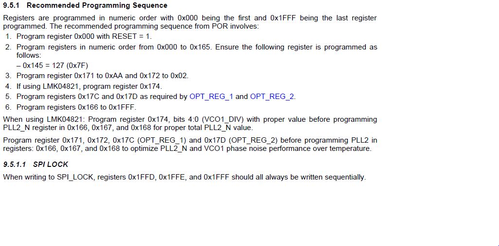

                    We have questions about the writting sequence of LMK04828 register:
                    The register of SPI LOCK[7:0] is written lastly, and the value of 83(dec) is written into SPI LOCK[7:0]
                       83: Register unlock
                      Why should the last register(SPI LOCK[7:0]) is written into the status  of  unlock?
                      what is the function of SPI LOCK[23:0]?
                      Thank you for your review and help.

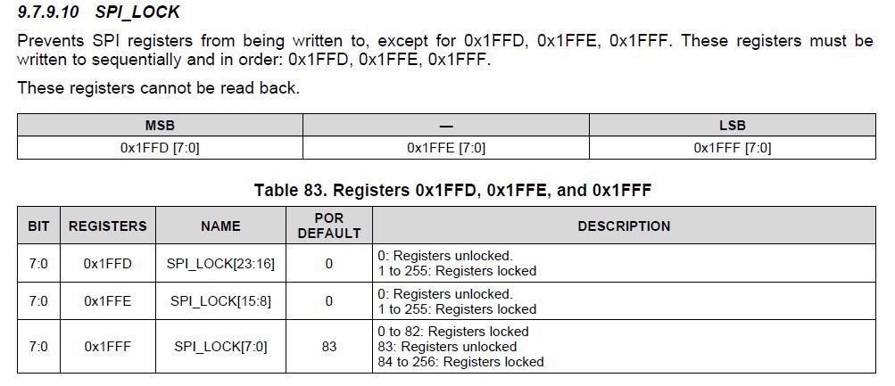

  • Hello Jinfeng,
    Think of SPI_LOCK registers as a write-enable control. By writing SPI_LOCK[23:0] != 0x000053, all registers except SPI_LOCK cannot be modified by the SPI bus. By writing SPI_LOCK[23:0] = 0x000053, all registers can once again be modified by the SPI bus. SPI_LOCK feature was requested by a customer during development, because their SPI bus was shared with other devices and they did not have enough chip-select outputs for all devices on the bus. For cases where each LMK04828 has a distinct chip select input, or if each LMK04828 shares the same register programming, SPI_LOCK feature is not necessary.
    If you do not need the SPI_LOCK feature, you can skip writing these registers. The POR default settings allow all registers to be written normally.
