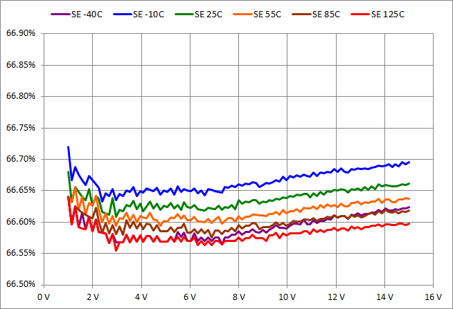

I'd like to know about accuracy over full temp for SE555.
According to data sheet, it said at only TA=25℃.
Do you have MIN/MAX accuracy over full temp?
I read Ron's thread.(https://e2e.ti.com/support/clock-and-timing/f/48/p/879112/3251945?tisearch=e2e-sitesearch&keymatch=SE555%20Accuracy#3251945)
