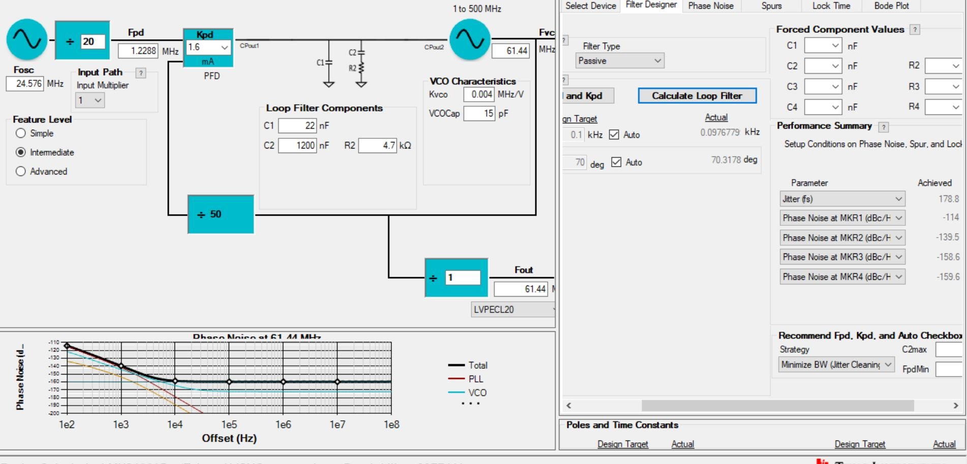

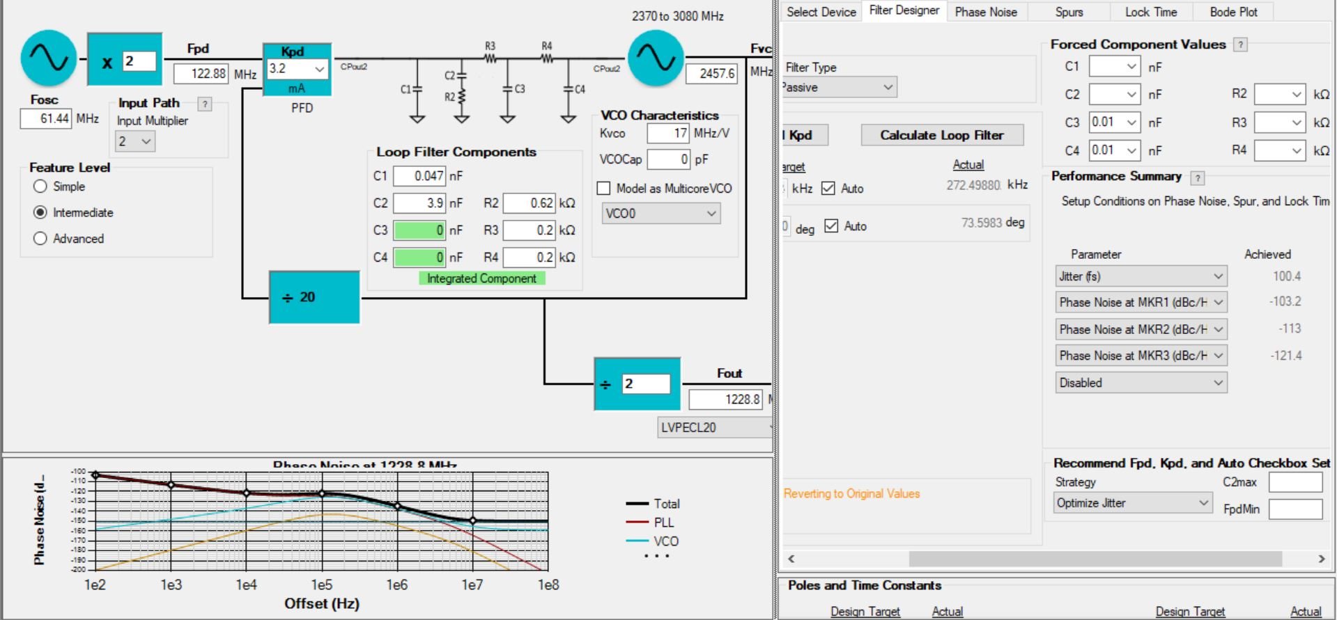

I'm using LMK04228 to clock AFE7769. Below is my design for filter, charge pump gain, etc. Could you pls help review the PLL1 and PLL2 loop design is fine for low jitter? I would like to minimize the jitter and make sure PLL1 is stable to be locked to 24.576MHz. After that, I will focus on checking the internal PLL design of AFE7769.

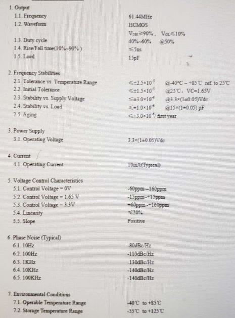

The VCXO characteristics of PLL1 are Kvco=4kHz/V and load=15pF.

  • Hi Jerry,
    PLL1 looks okay, but it's hard to tell without the VCXO metrics. Do you have a datasheet for the VCXO, or at least the phase noise performance of the VCXO at a few offsets e.g. 100Hz, 1kHz, 10MHz?
    In the most recent PLLatinum Sim update (just a few weeks ago), we made some updates to LMK04828 (and therefore LMK04228) performance. For example, the Kvco value I predict for PLL2 is 20.8, not 17; consequently my C1 = 0.068 and my R2 = 0.56kΩ, which seems to yield slightly better performance.
  • Thank you, Derek.
    You could find the VCXO specs for PLL1.
  • Hi Jerry,

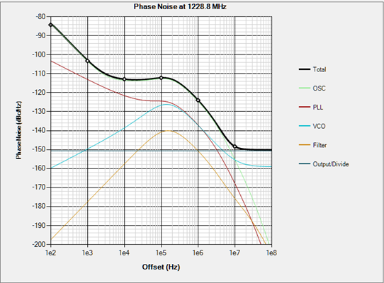

    Thanks for supplying the VCXO characteristics. The noise performance on that VCXO is modest (-140dBc/Hz at far-out offsets), so the PLL2 performance is actually completely dominated by PLL1 performance:
    I calculate about 300fs jitter 12k-20M at 1228.8MHz using this VCXO.
    PLL1 and PLL2 both look stable.
