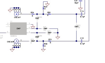

Hi team.
I want to use OSCin in common mode. In datasheet written: "Reference input clock (–). High impedance self-biasing pin. Requires AC-coupling capacitor." The lmx2594_EVM datasheet contain the folloing picture:
But i think it is possible an another connection:
Both inputs, OSCinP and OSCinM, are DC-coupled. Is it correct or I mistake?
