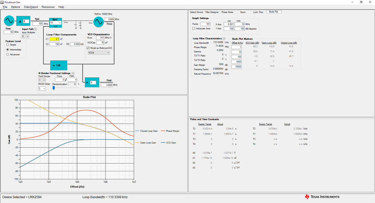

I've just started a few very simple simulations of LMX2594 PLL. I keep finding the quoted Loop bandwidth does not match the Bode plot and is out by over a order of magnitude.
I specified a loop bandwidth of 100 kHz and phase margin of 70 Deg. Clicked Calculate Loop Filter, there were no errors like VCOCap/MinHighCap Restrict Bandwidth, new filter values appeared and phase noise changed. The summary at the bottom has a realistic loop bandwidth - 110 kHz vs 100 kHz specified, but the calculation trimmed to realistic values for R & C so this error seems reasonable.
The Bode window shows a markedly different gain in the chart and the marker data. The 0dB point is maybe 4.3MHz. The phase margin hits ~70deg at 110kHz - so that looks correct. Its like the calculated Bode gain is maybe 30dB higher than expected.
I have tried also with 3rd and 4th order scenarios and had the same issue.
Below is a screen shot of the Bode window.
Regards David
  • David,
    The difference is a factor of 20*log(N) for the open loop gain.  So instead of checking where the open loop gain crosses 0 dB, check where it crosses 20*log(N) and you should get the results you want.  I can't read the feedback valuefor 20*log(N), but it's at the level the the closed loop gain is at low offset frequency.
    dean
