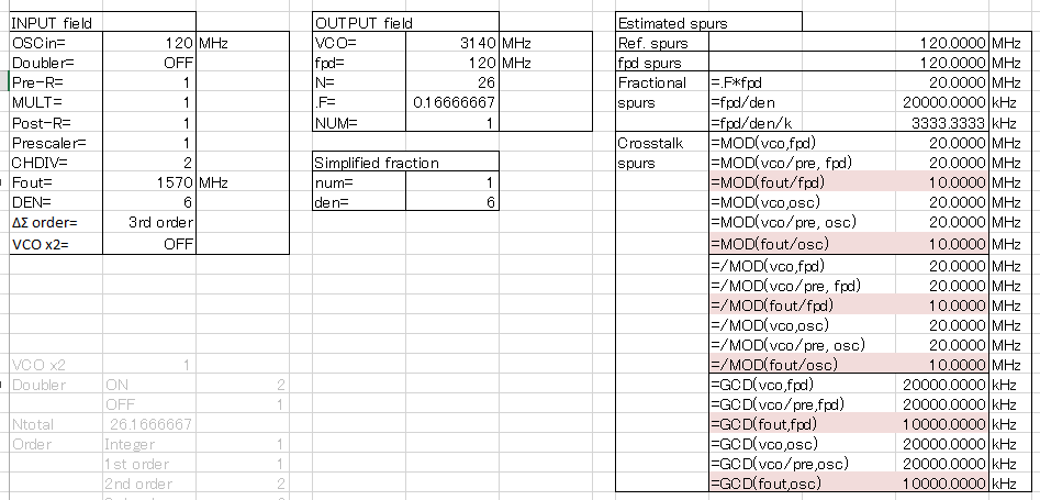

The setting frequency is Fosc=120MHz, Fpd=120MHz, Fout=1570MHz.
Changing the "VCO_SEL" setting will improve the spurious. Is this an effective setting for spurious measures?
However, it does not improve the 1560MHz spurious. What could be the cause? And is there a way to improve it?
If you check the calculation result of Spurs finder, you can see 10MHz in Crosstalk spurs. But I don't know how 10MHz is calculated.

    The 10MHz spurs came from crosstalk between fpd and output. 120 x 13 = 1560MHz. Output = 1570MHz, so the spurs is 10MHz. You can try make charge pump smaller, see if that would reduce the spurs a bit.

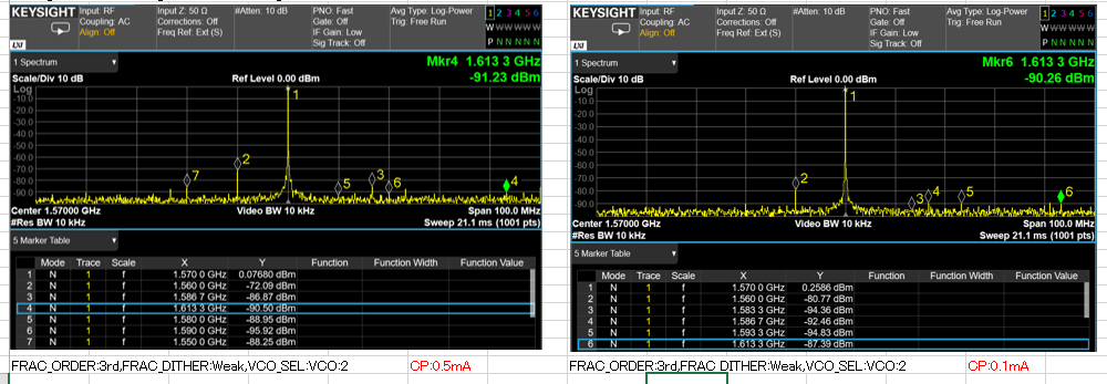

    I changed CP from 0.5mA to 0.1mA.
    As a result, it was confirmed that the spurious at 1560MHz was improved by about 9dB.
    By the way, is it difficult to reduce the noise level below that of the spectrum analyzer?
    Also, is there any other way besides changing the CP current?
    Is it best to change the CP current and then secure the phase margin and phase noise (change the loop filter constant)?

    You may also try using a smaller fpd, for example, 60MHz, the 1560MHz spurs should be smaller.
    Since changing fpd or charge pump current will change your existing loop bandwidth/phase margin, you may need to redesign the loop filter using the updated fpd or charge pump current.
