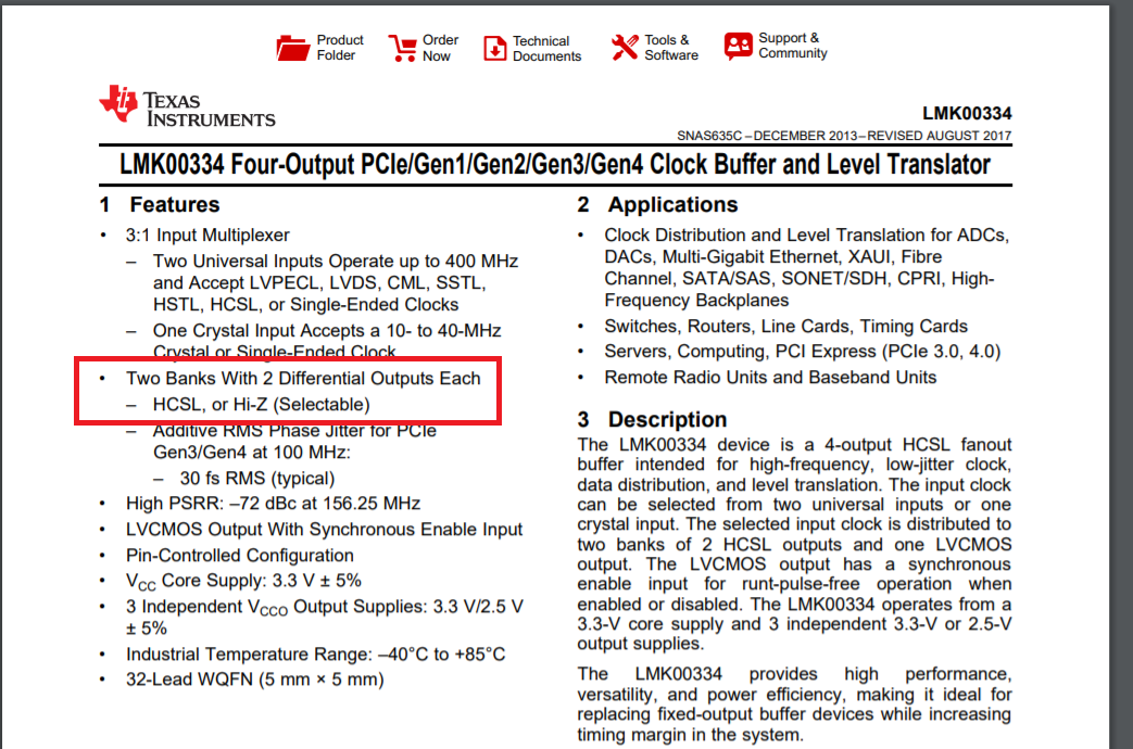

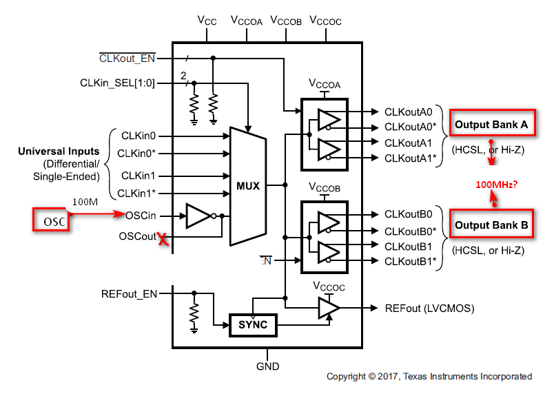

I have a question about LMK00334 as below:
When select OSCin with an single -ended external clock as a input, OSCin =100MHz, OSCout floating,The the CLKoutA0、CLKoutB0 = 100MHz?Can it support this Mode?

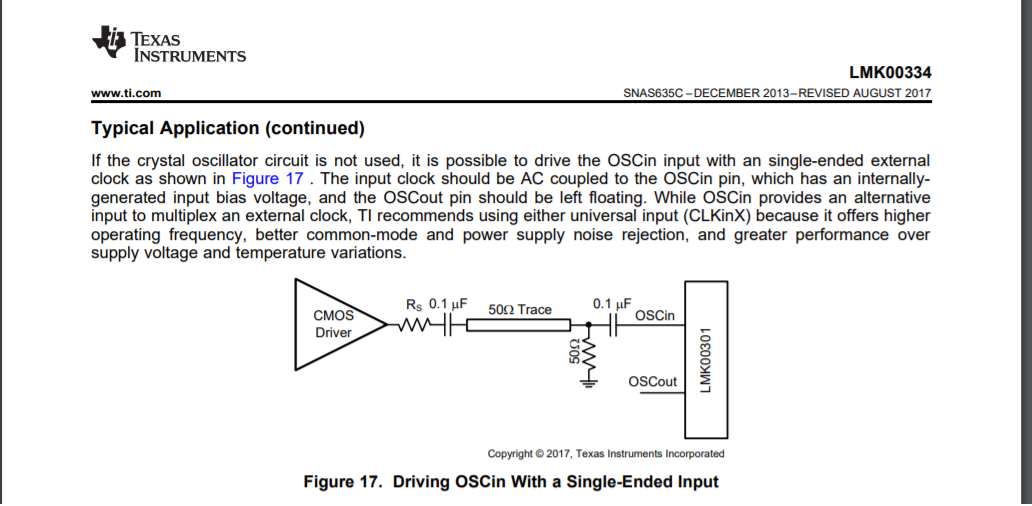

Hi Customer,
This mode is indeed supported by LMK00334. Please see below the datasheet snippet describing this mode of operation. Do note that TI recommends driving the LMK00334 using the universal clock inputs which also support single-ended signals for better overall performance.
If you have any more questions, i will be happy to help.
