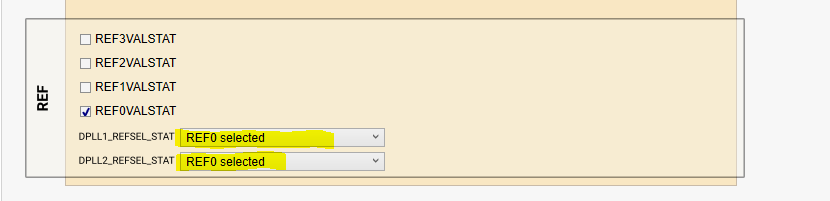

    Yes, that is correct, "DPLLx switchover event" does go high during a switchover, however this will be a pulse and a very small window. The best signal to monitor to confirm a switchover has indeed taken place are the following:

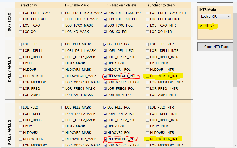

    - REFSWITCHx_INTR: should go high after switchover an remain latched until cleared. Make sure int_en is on. And secondly the POL bit needs to be enabled for it to be
    - DPLL_REFSEL_STAT: will show which reference DPLL has selected

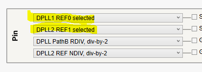

    - DPLL REFx Selected on status pin or GPIO pin: will go high for which ever reference is currently selected if the "x" equals that reference number
    I have a picture of these from the GUI below.

    Once switchover happens, Switchover_INTR will be triggered and remained latched until cleared (unlike REFswitch which would have to be perfectly captured / readback at the right moment)
    DPLLx_REFSEL_STAT will let you know what reference is selected - therefore letting you know whether DPLL has switched reference
    DPLLx_REFx_SELECT - will be high when DPLL has selected that reference
