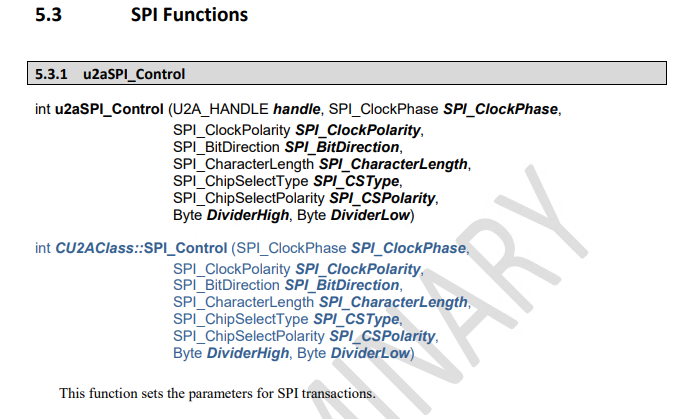

I would like to change the SPI frequency for the LMX2592EVM board.I understand that the max rate is 8MHz. What is the reason for this value?
I am using TICSpro software and USB2ANY.
Hi
I have done some digging, and found the document covers the API for USB2ANY. There's an option to change the SPI clock rate using the following command:
The question is whether it's possible to access the USB2ANY API through the TICSpro setting
This is really important for us, since we are seeing issues related to lock time when working on slow SPI rates.
