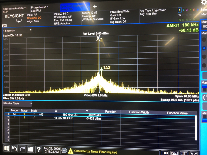

    Yes,there are many different types of spurs and different kinds of causes so we have to identity them and then minimize them.The spurs i met are sub-fractional.let me show you as follows,this is just one frequency :
  • Hi There,
    If your programmed VCO frequency is 10288MHz, I can see fractional spurs at multiple of 53.33kHz. You can try use 2nd order MASH, the spurs frequency will change to multiple of 80kHz.

  • Hi Noel,
       I have tried your advice to change DEN from 184320 to 184320001,there still some fractional spurs at VCO frequency such as 11038.16M,11538.16M.
    Of course,i haven't test all the frequency of my used band.This spur is within LBW,do you have any other advice to suppress it below -70dBc  except change LBW more narrow.The configuration is the same as before,i just change N,DEN and NUN registers then set FCAL_EN=1 when i change frequencies.
     The data is as follow:
  • Hi There,
    What is the MASH_ORDER?
    Can you try different MASH_ORDER and adjust PFD_DLY_SEL to see if the spurs will go down?

  • Hi There,
    A wide loop bandwidth is desired for lower phase noise and jitter.
    However, all the fractional spurs, in this case, are multiple of 80kHz. That means the loop filter is not able to reduce their magnitude.
    If you can tolerate phase noise or jitter, you can reduce the loop bandwidth in order to reduce spurs.
    You may first try reducing charge pump current. In general, smaller current returns smaller spurs. In addition, without re-design the loop filter, a smaller charge pump current will reduce loop bandwidth, it should help reducing the spurs a bit.
  • Hi Noel,
       Right,the original purpose of designing a wide loop bandwidth is to get optimal phase noise.
    I have tried to reduce  cp current  to 6mA(original is 12mA),the spurs at this frequency have lowered to an acceptable value.
